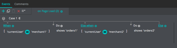

Hi John,
Are you referring to having the Username be displayed on screens? If so, just create another variable that detects which user enters, then have a 'On page load - set value' event for the element you'd like to display the username.
Let me know if this isn't what you're looking for.
How do i go about detecting which user logged on?
Upon a successful login, you can store the user value into a variable before leaving the page. That value will persist through the session (until you programmatically change it or reload/restart the session) and use that variable as a test on each case for different functionality.
when usernameVar = user1 do someActionHereFor_user1
else
when usernameVar = user2 do someActionHereFor_user2
