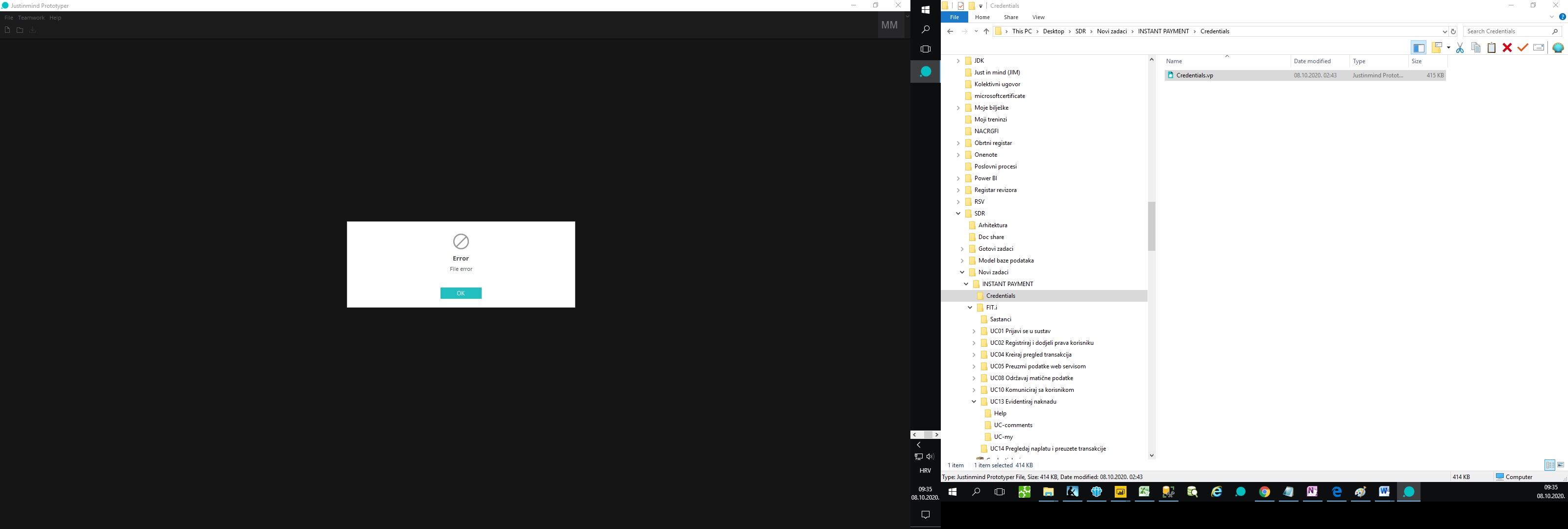

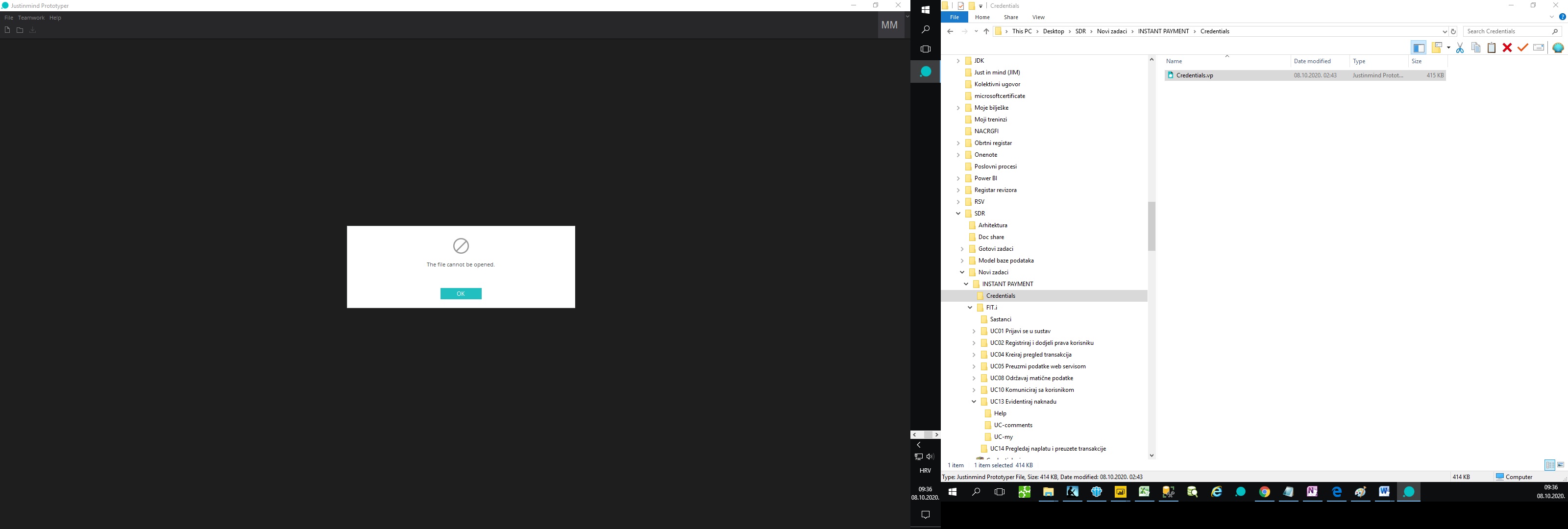

Unable to open file "Credentials.zip".
Please check attached error messages.
I have Justinmind Version (Ver. 8.6.0)
My apologies, I had exported this prototype from version 9.
Below I have attached the same example from version 8.6.0
