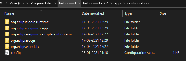

Could you check to see if you have some log files on the ‘configuration’ folder? Here is the file path:
Windows : installation folder/app/configuration
Mac: Justinmind.app/Contents/Java/configuration
If there are log files in there, could you attach them here?
No I don't see any logs in the folder..

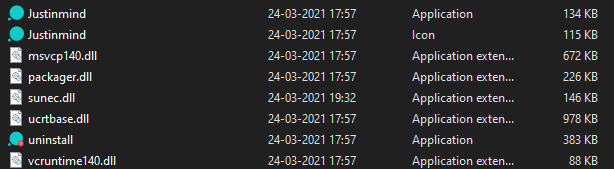

Please could you try to copy the sunec.dll file that you'll find at "Justinmind installation folder/app/jdk/bin" and copy it to the root of the installation folder, next to the Justinmind.exe. Try to launch the application again nad let me know if it works.
Again, thank you so much for you help.
Nope. Still not launching.
