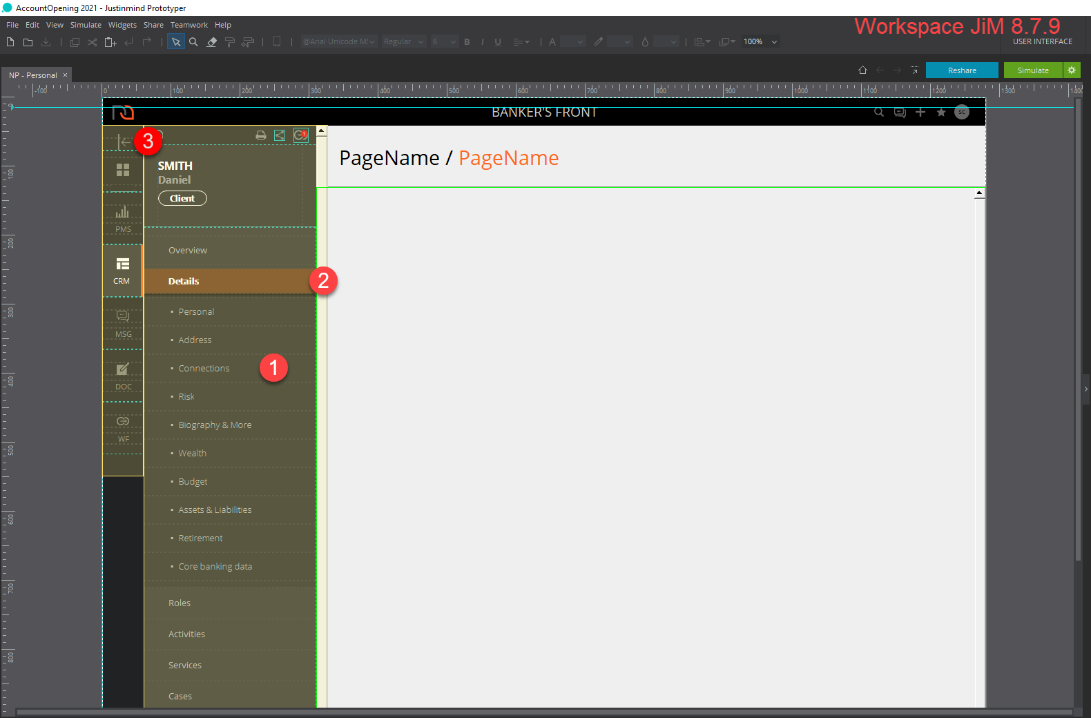

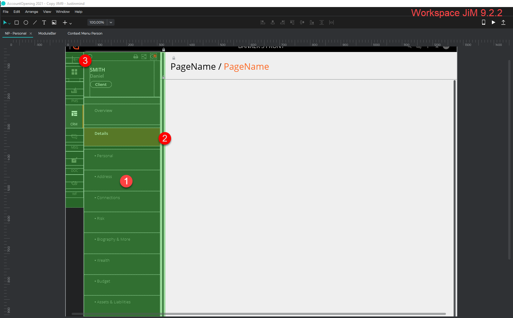

Point 1 - text tables: cell size & contentIn workspace, in v9 the size of most text table cells is not retrieved properly . The content of the cells are not properly placed either.

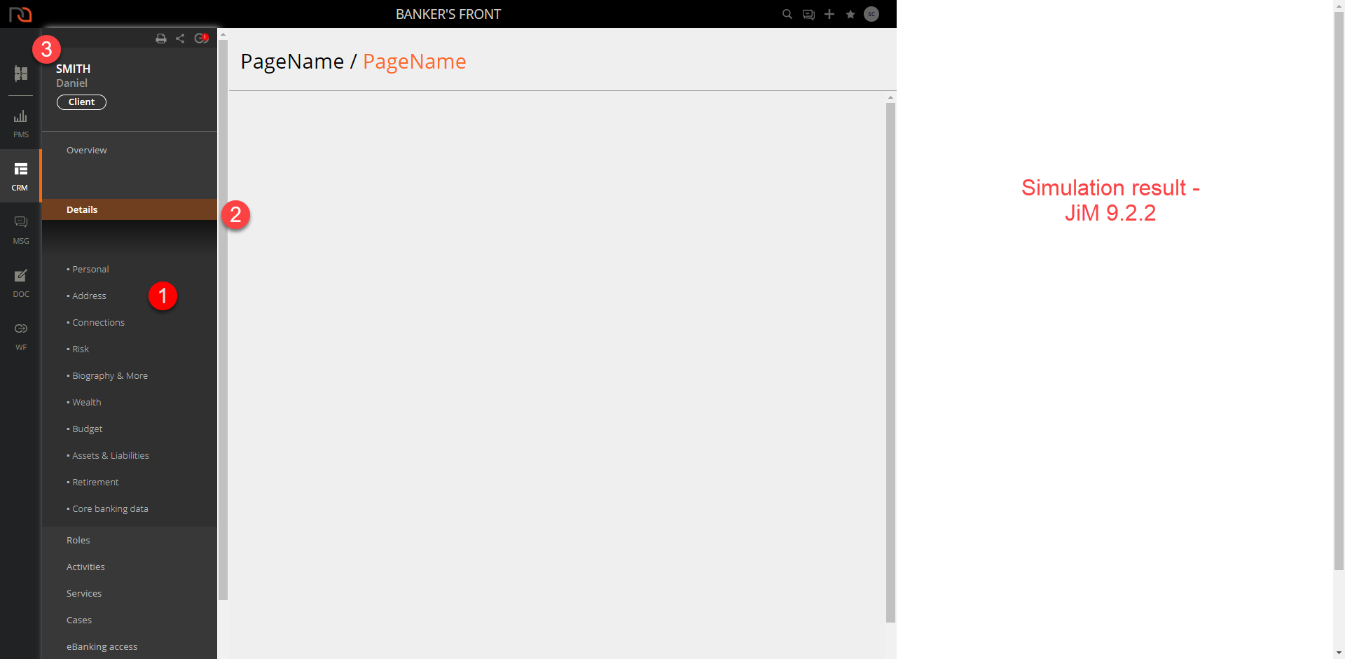

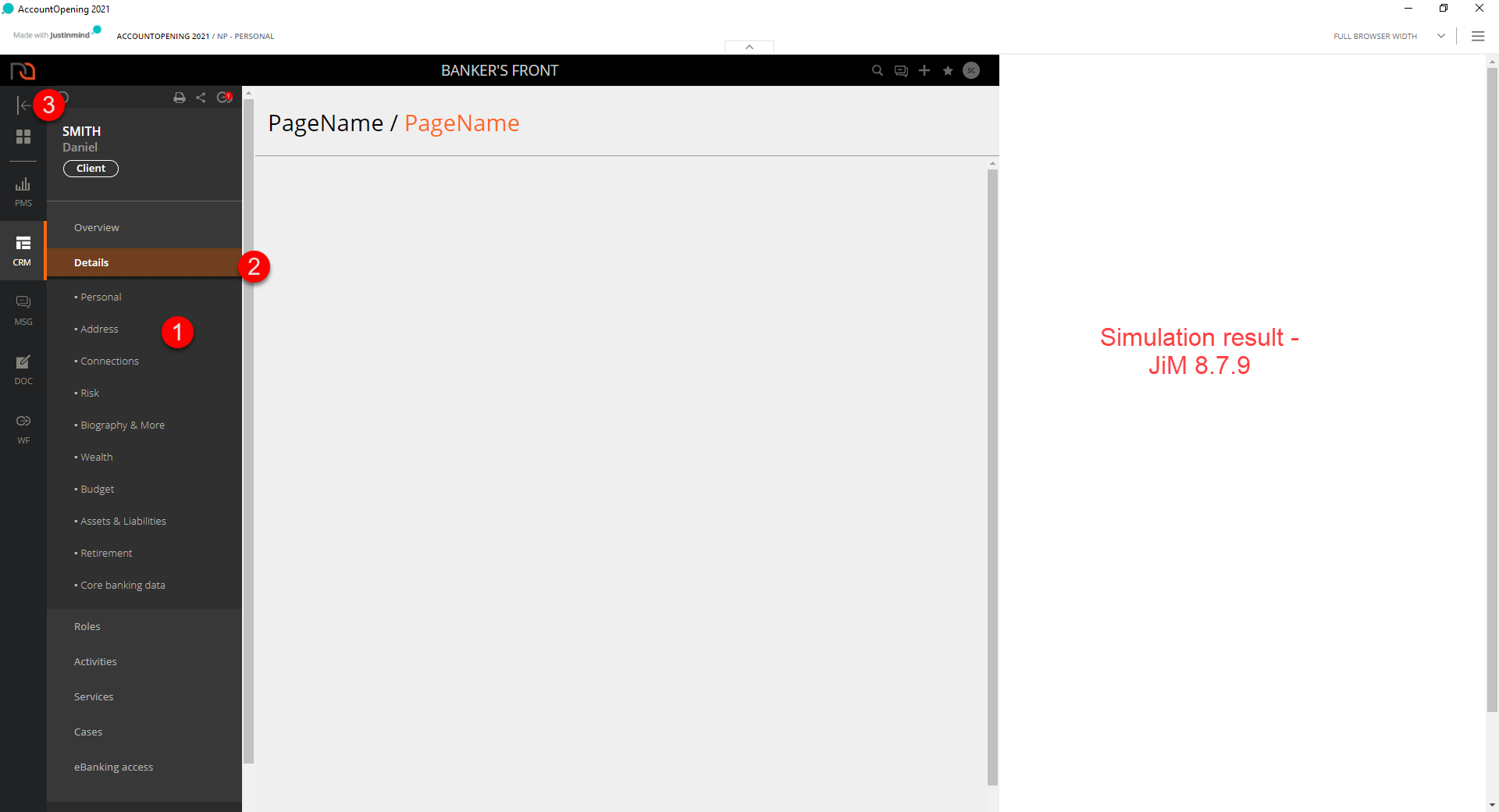

In simulation, in v9, there are huge difference between what shows the workspace and the simulation results.
Point 2 - text table: slim cellsIn workspace, in v9 the two slim cells above the orange cell are retrieved correctly.
In simulation, in v9 the results are crazy.
Point 3 - Image position
In workspace, in v9, the image is placed correctly.
In simulation, in v9, position is wrong.

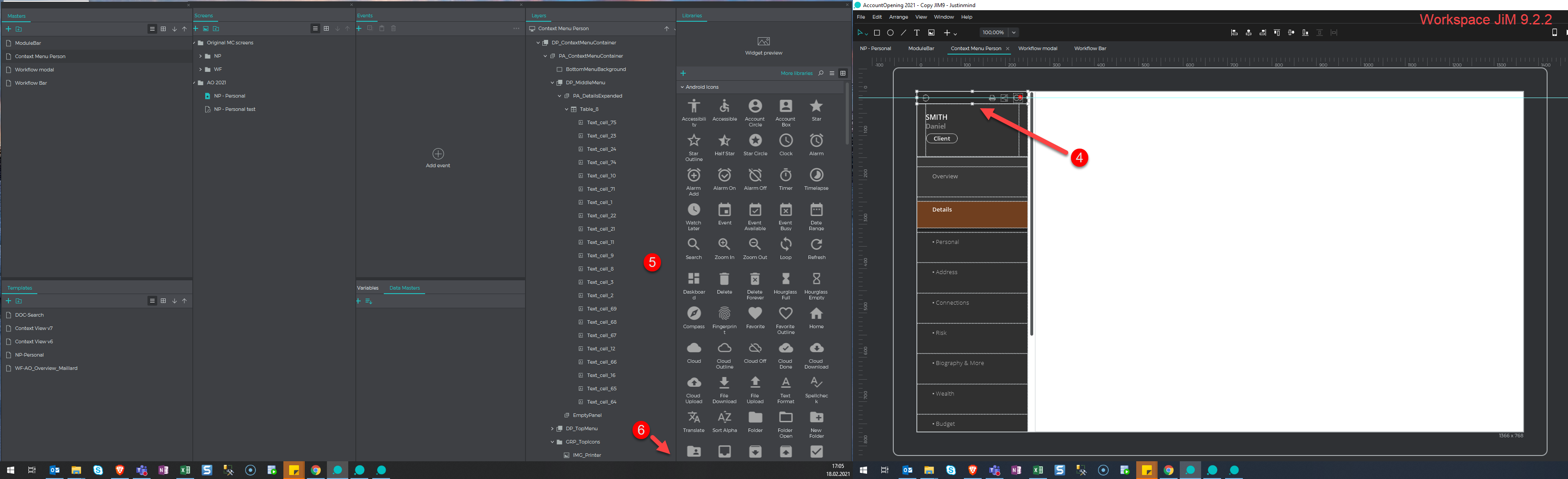

Bonus - illustration of the buggy interface:
Point 4 shows that I've selected a rectangle
Point 5 shows that the selection is not reflected in the layer window. You know why ? Because the element is at the very bottom of the list, however there is no scroll bar to display it !!
Point 6 shows that I cannot resize the layer window (actually, not any undocked window). The reason being that the button allowing to resize the window is out of my screen (in a 1920x1080px resolution). After some tedious manipulation I could display it and resize the window. Bad luck, each time I restart the application the window gets resized and the button disappear ! Amazing !
