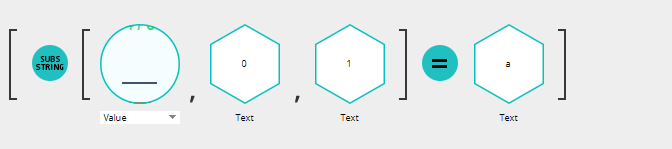

Hi Krishna,
You should add the expression attached to the event.
thanks it works fine i was trying to do this but could not get it properly.
