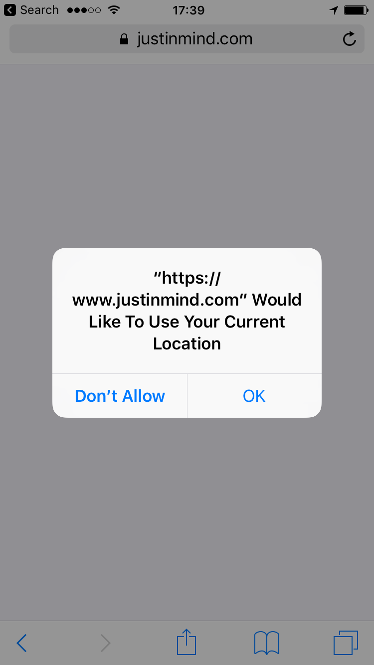

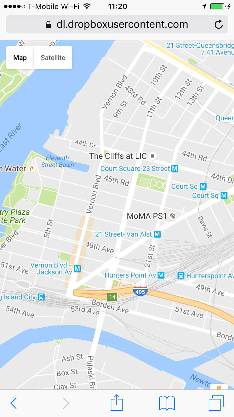

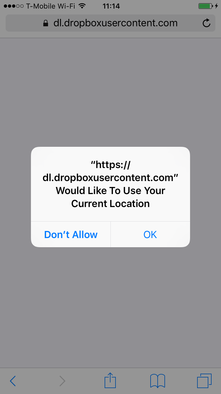

I've attached a zip file containing a project that works on my device (iPhone 6s/Safari 9.3.5) as well as 2 screenshots from it requesting permission and displaying on my device. You can see it running live via your device here: https://dl.dropboxusercontent.com/u/628429/justinmind/geolocation/index.html#/screens/d12245cc-1680-458d-89dd-4f0d7fb22724
If you're using iOS I'd double check that you're allowing Safari to use your location (Settings>Privacy>Location Services: Safari Websites: While Using)

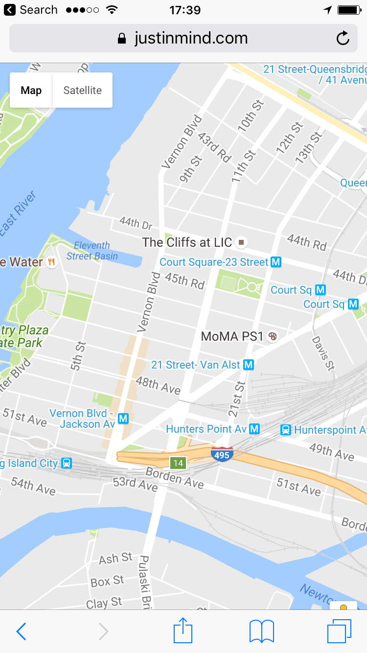

I've looked at this URL you've just shared on both desktop and mobile Safari (iOS 9.3.5 and 10.0.1) and I'm able to see the map rendering in the mobile browser. Please see the attached photos.
