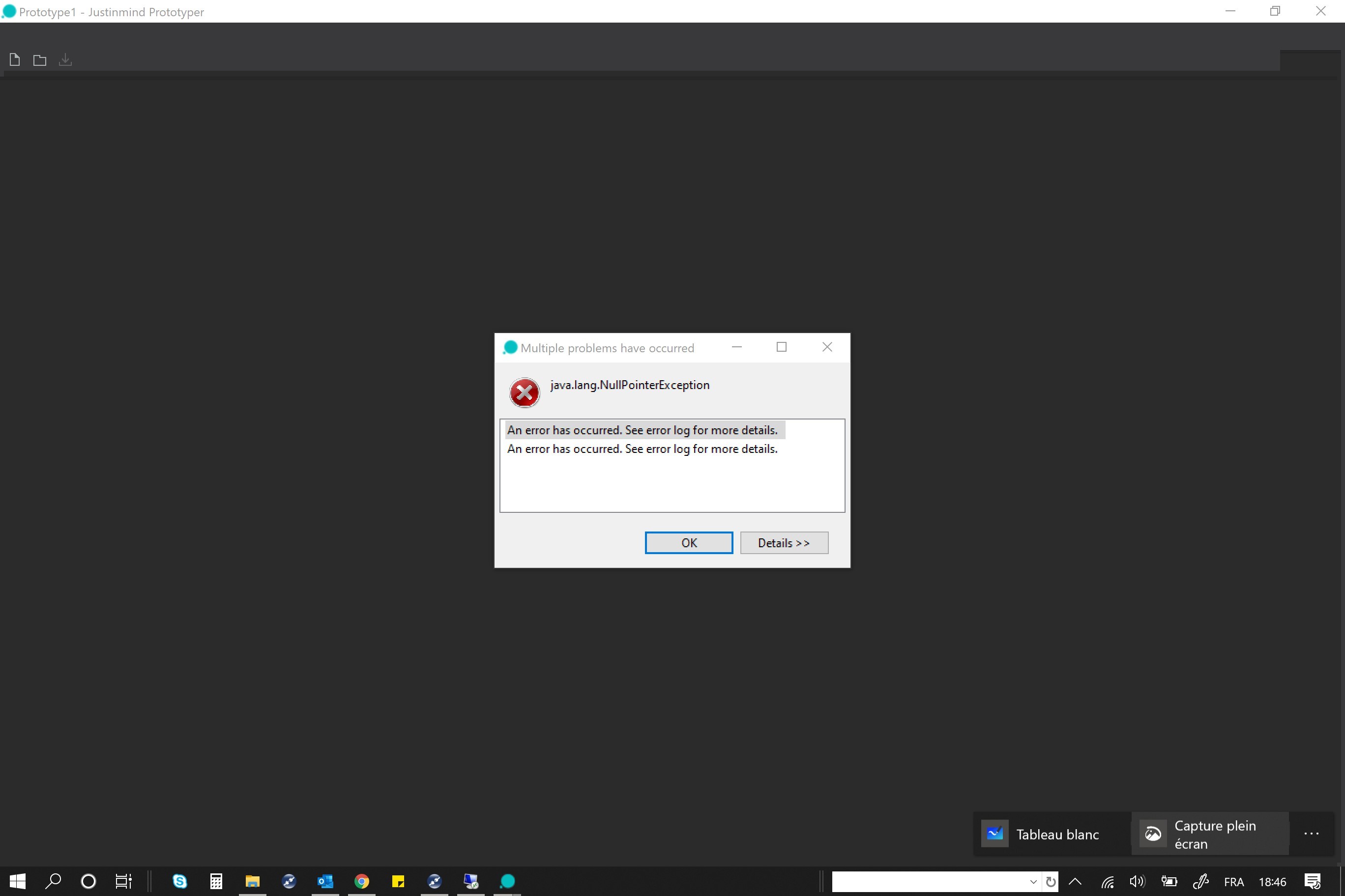

I am using Adobe XD program to create screens to be used in justin mind, I follow each steps to create the XD File for justinmind but When I open it in justinmind the Following error appears "Java.Lang.NullPointerException"
Any idea what it is ?

at same time I've included the screenshot for the message error
