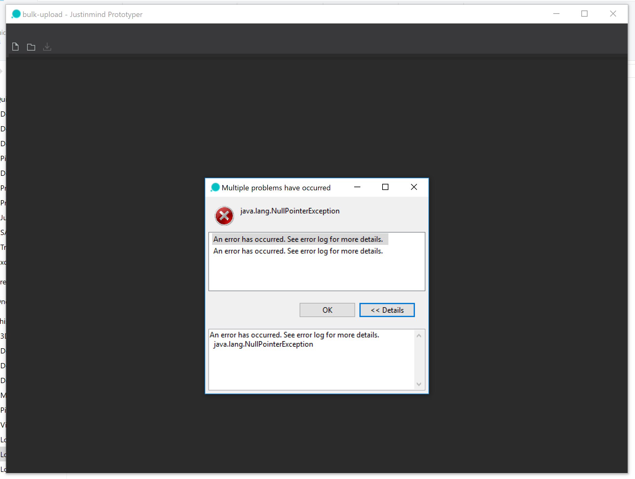

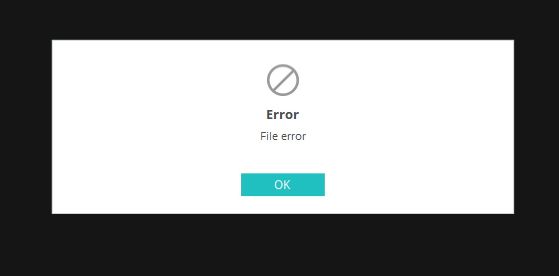

I exported a file having multiple screens from Adobe XD using the Justinmind to XD plugin. But when I try to import that file into XD it shows an error. Screenshots attached. Tried with just one screen as well. Unable to attach the exported Justinmind prototype file here.

I have the 1.0.2 version of the plugin. I figured that if I have any symbols, components, groups or compound svg shapes then the converted Justinmind file throws an error. I was able to get a readable file after I removed the headers, all svg images and also ungrouped all elements retaining just basic shapes. Its a workaround for now but I hope that gets fixed in the future versions of the plugin.
So the file is still crashing? If so, can you try uninstalling the Justinmind plugin in Adobe XD and try reinstalling it?
I tried re-installing the plugin. I am still getting the file error in the exported file.
