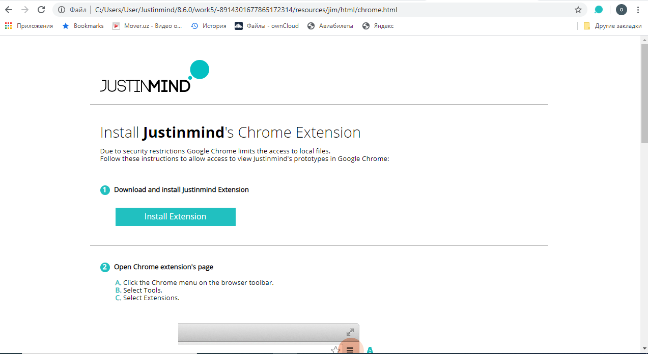

i can't simulate my JustInMind prototype.
- if i click to "simulate" the program ask me to install chrome extension. i've installed. but when i click to simulate the program ask me again and again to install extension

What version of Justinmind are you using? We recently issued an update that should fix the issue with simulating - it was due to a Google Chrome update that changed how the plugin can work. Try going to Help > Check for updates to download the newest version.

i've installed the extension, but my prototype isn't being opened by chrome
It looks like you're running exported HTML. Did you create that with an earlier version of Justinmind? If so, you'll need to export it again with version 8.7.7 for it to run correctly.
