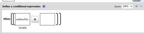

What is the proper way to set a variable to "blank", if it already contains text, so the following condition will work?
this condition is only working when the variable is initially blank but once I add text and then try to set it to blank, it does not work

We checked and you defined the wrong expression. To set a value in a variable you have to define this event: on[something] --> set value --> variable --> value is --> 'the value you want in your variable'. So in your case it would be a set value --> variable 'varShowFile' --> value is --> 'no'. But instead of 'no' you have set 'varShowFile = no'. So change that by just 'no'
