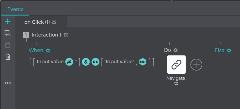

I am setting this to work off of my continue button. How do i get the continue button to navigate to the next page after all fields have validated? thanks
Hi Steve, this condition should be attached to an event "on click" + "navigate to" (new screen). Tell me if this information is useful.

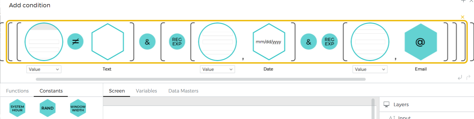

Hi Ria I have 8 fields to check, do I have to add 8 inputs to the expression? thx
Hello Steve, you can add the functions you need. I attach a capture of how it would look.
Ria.
Files: nc2.PNG
I find this condition drag drop difficult to use. I can't replicate what you have in your screen capture.
Hello, here is an example where you can see the interaction.
let me know if this is helpful to you.
