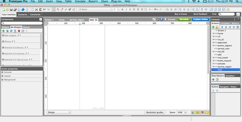

I still don't see it. Here my screen shot. Is it on the right or left. CAn you send me a screen shot of where i can see the events tab? 9690f34d8a1bc20ba1814d3212ff116a
Click on the little arrow icon at the bottom-center of your screen
Perfect!! it worked! Thank you so much!
