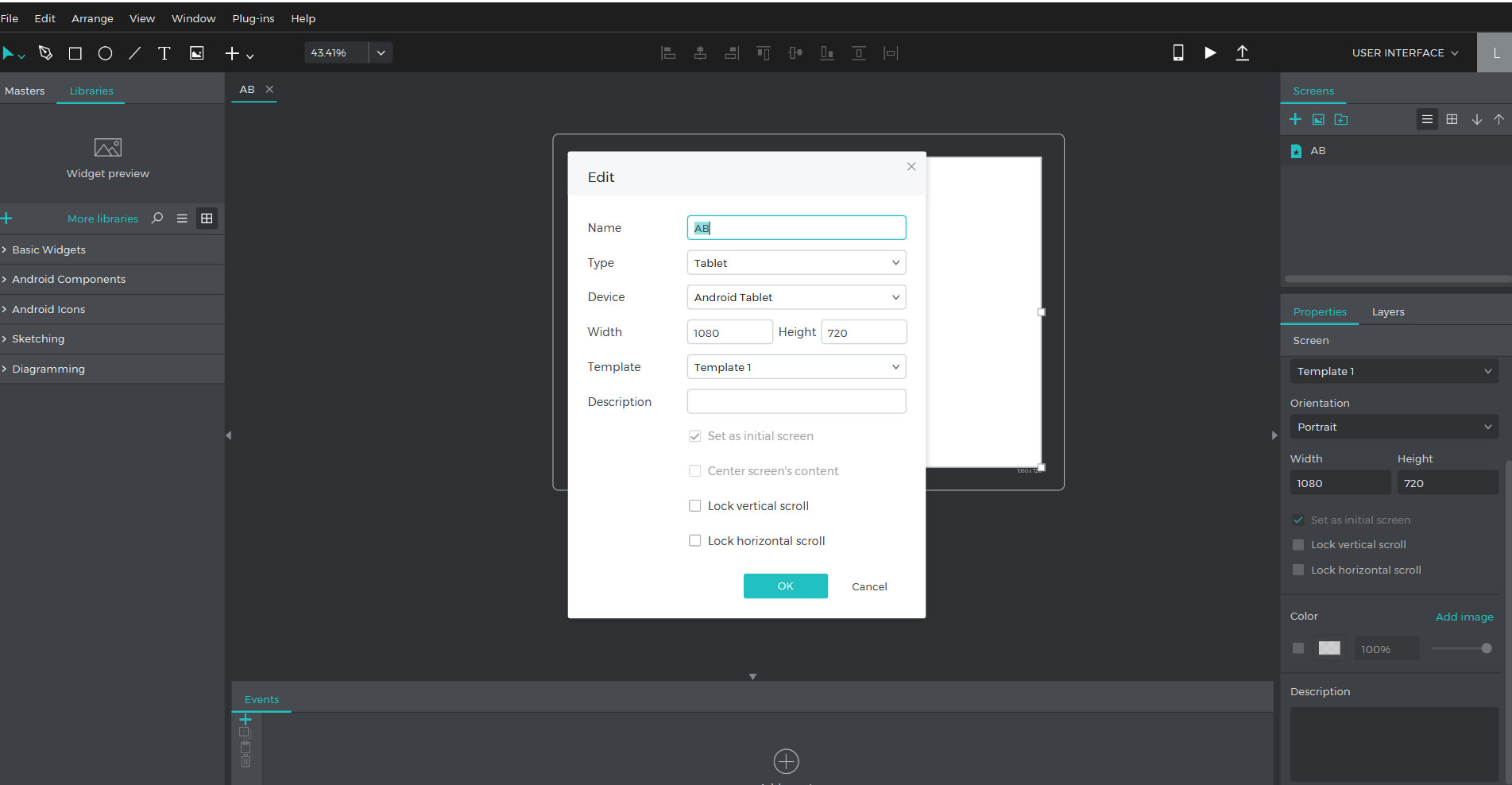

My "Center Screens Content" is greyed out on every Screen template I use ... Any ideas why?
Hi Liam,
can you please send me a capture of the issue?
I have attached the screenshot - No matter whether the Lock Vertical or Horizontal etc. is ticked the Center Screen is still greyed out.
Thank you for your expedient response too!!! :-D

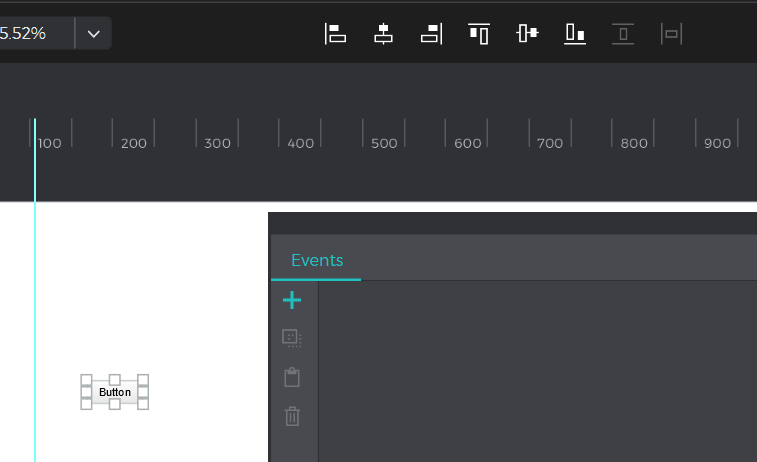

Hi Liam, the alignment bar should be enabled when selecting one or more elements of the canvas, could you tell me if the error still happens in this case?
Greetings
Files: all.PNG
It is not the alignment bar's state that is the issue(it's working 100% when there is an element on the canvas), but rather the issue is that when I dynamically resize an image in an event animation, it is resizing from the top left when I would really it rather resize from the center.

The option that is grayed out in the "Center Screen's Content" dialog is disabled for prototypes that are mobile / tablet. With a web prototype, the option should be enabled.
