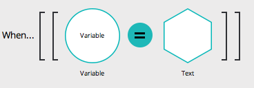

To see the condition, make sure you are looking at the base page of Screen 1. You can do this by clicking on the base screen (icon that looks like a computer monitor) in the outline palette. I have also attached two images - one is the event that you will see when you select the base screen. The other is the condition. The condition detects if the variable is blank. Does that make sense?
