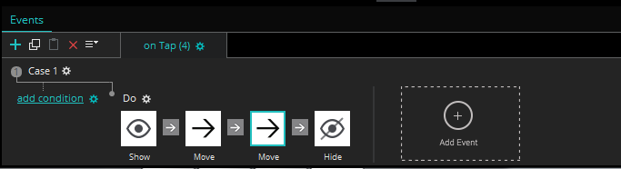

I need to move two or three or more icons to different locations just from one ontap, I was able to do that but movement but one after the other but that is not what I want, I need to move them at the same time to different places

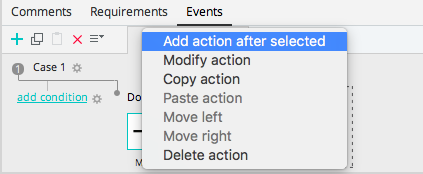

Click on the 'gear' icon next to the event action, and then click on 'add action after selected.' See screenshot.
Hello Danielle, ok I did that for the first icon and then for the second icon, so now the two movements appear after each other and when I simulate they still move one after the other not together
Click on the gray arrows and you'll see the option to make the events 'WITH' each other (occurring at the same time).
Ok got it, that did the trick, thanks and best regards
