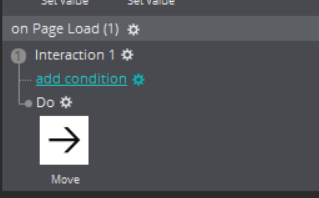

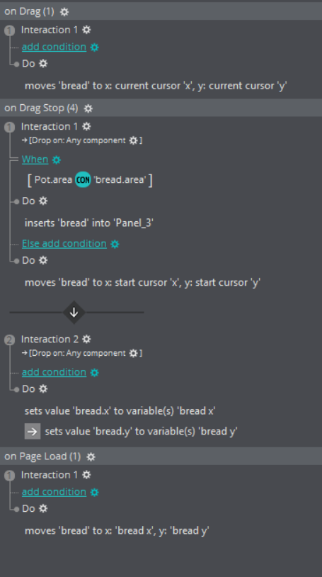

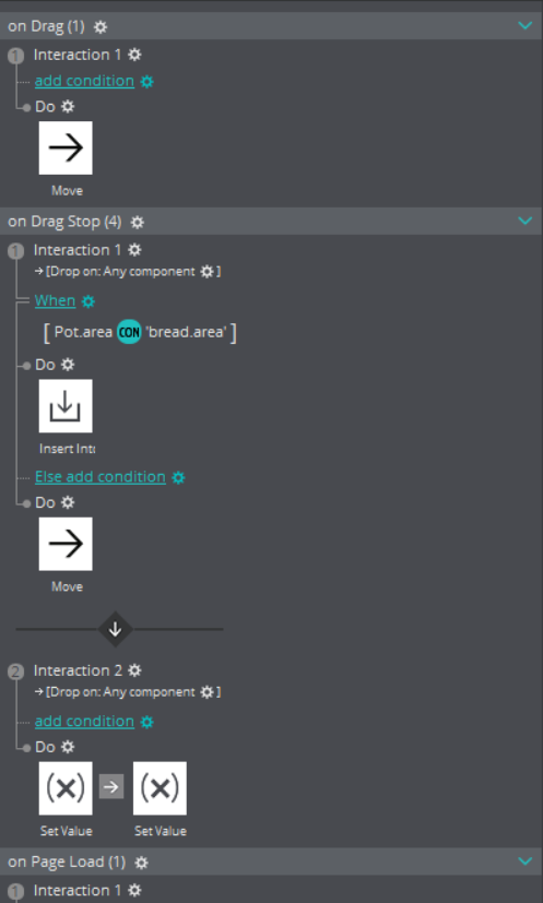

here are snapshots of my events. hope that helps
