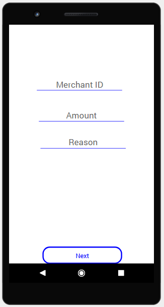

On screen A, user is required to enter Merchant ID and Amount. Then on screen B, I need to see a summary showing other merchant details based on the ID entered.
Eg: In a datamaster named "Merchants", I have fields including Merchant ID, Merchant Name, Location and Telephone and i have added records. Lets assume I have a record with the values Merchant ID="123456", Name="City Shoppers", Tel= "07123456789" and location="Kampala".
User enters the ID 123456 on screen A and on screen B, I should be able to see a summary of the other information based on the ID.
I have created an On-Page Load event but cant figure out the expression to filter info based on the ID entered.

Hi Danielle, thanks for the response. However, when i use Data Grid/ List as shown in the video, the output includes all the records in the Datamaster. What i need is to ouput only the information from the row whose ID was entered at sreen A (Just one record). I have attached sample screens.
