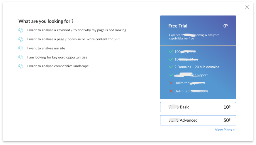

I'm attaching a screenshot of a pop-up on a page for a web app
1. How is the dynamic panel to be defined - is it within the page layers, or a separate panel in masters? how do you connect the two..or call the pop-up from the page?
2. How does one switch between different states of a dynamic panel? - as you can see I have 5 radio buttons and I'm looking at interaction to click each radio to show consequent changes on popup i.e. its panels

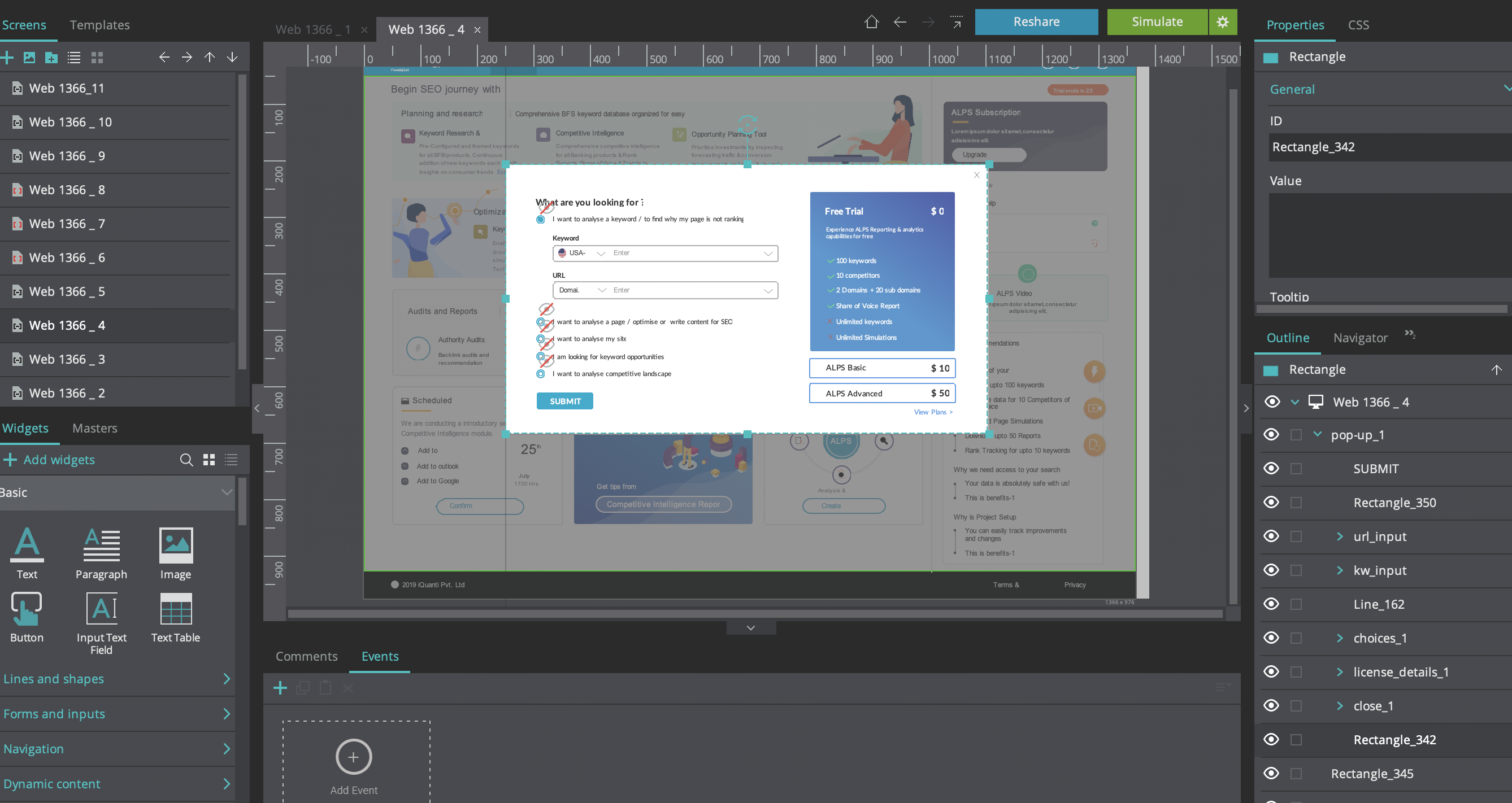

Hi, figure 1 is my situation right now. I have the entire selection/radio options stuff on a pop-up. I'm struggling to trigger opening the pop-up itself on the page.. which would ideally have the embedded dynamic panel among the layers as you demonstrated in your file.

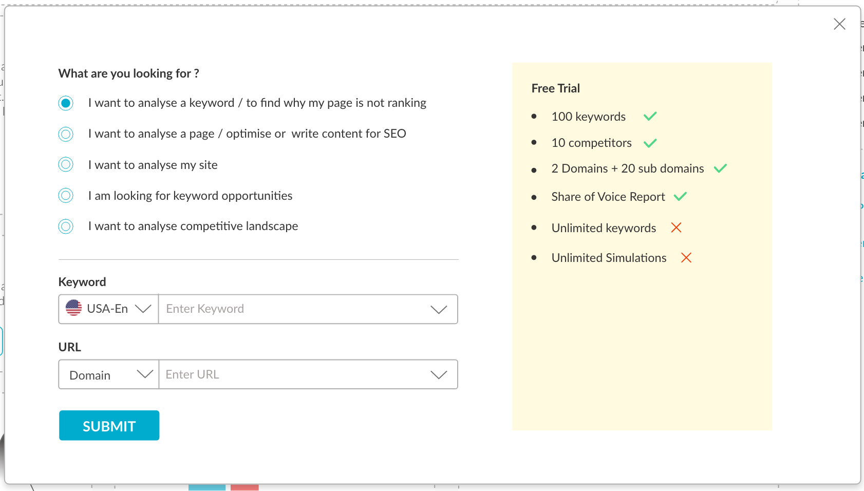

2nd issue is I think your demonstrated way will only work if I changed the layout to Figure 2, which is still doable. But my problem still remains about how to get the pop-up appear - do I make it a separate panel? then how do I call it on the UI that you see in background? Overlays? followed all tutorials..same steps but no outcome.
Btw, setting trigger PageOnload doesn't seem to work either, I've tried it multiple times, the s/w is quite glitchy I must say..following your tutorials isn't helping cause many times I don't find the controls in the same place, most times even after following all steps I get no results. Like the overlay bit, I've pulled out all my hair in the past 3 days.. frustration at its peak..im sorry to say. You guys must refund me, I can't find any people using this software to be honest..may cause its way too glitchy for the price.
I think I understand what you're looking for - a pop-up that you can show on the screen, which contains the different radio buttons and their corresponding panels? If so, the attached example should do what you'd like. The entire pop-up is a group, which is marked as hidden in the Properties palette. It's shown by clicking a button on the screen. Within that pop-up is the dynamic panel and the radio buttons.
