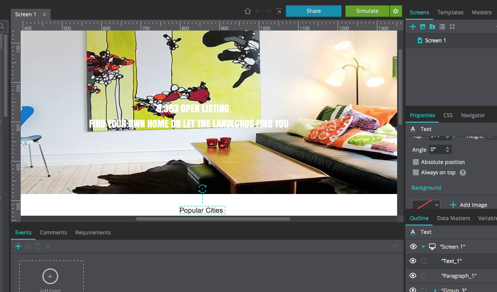

I have done in the similar way to get the image in the cell. Probably you didn't get my query. Please see the attached image. The big image is already there in the cell. And, I want to insert another TEXT element in the same cell but over the image. I am facing trouble when I try to place the TEXT on the image. It doesn't allow and the TEXT stays outside of the image.

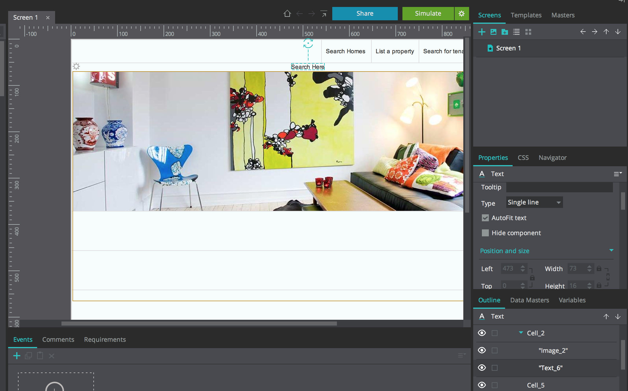

Apologies for any miscommunication. You can do this by changing the layout of the cell by selecting the cell, then looking to the properties panel and change the layout from vertical to free. See the attached screenshot.
