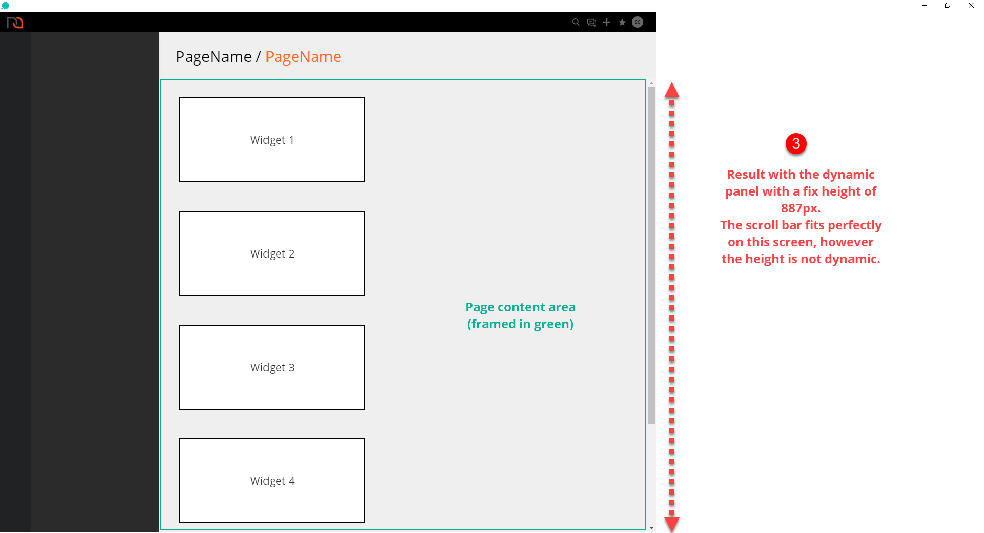

In our application we have the "page content area" (see screenshot 3). The height of this area adapts dynamically to the browser height. I could not figure out how to reproduce this in Justinmind.

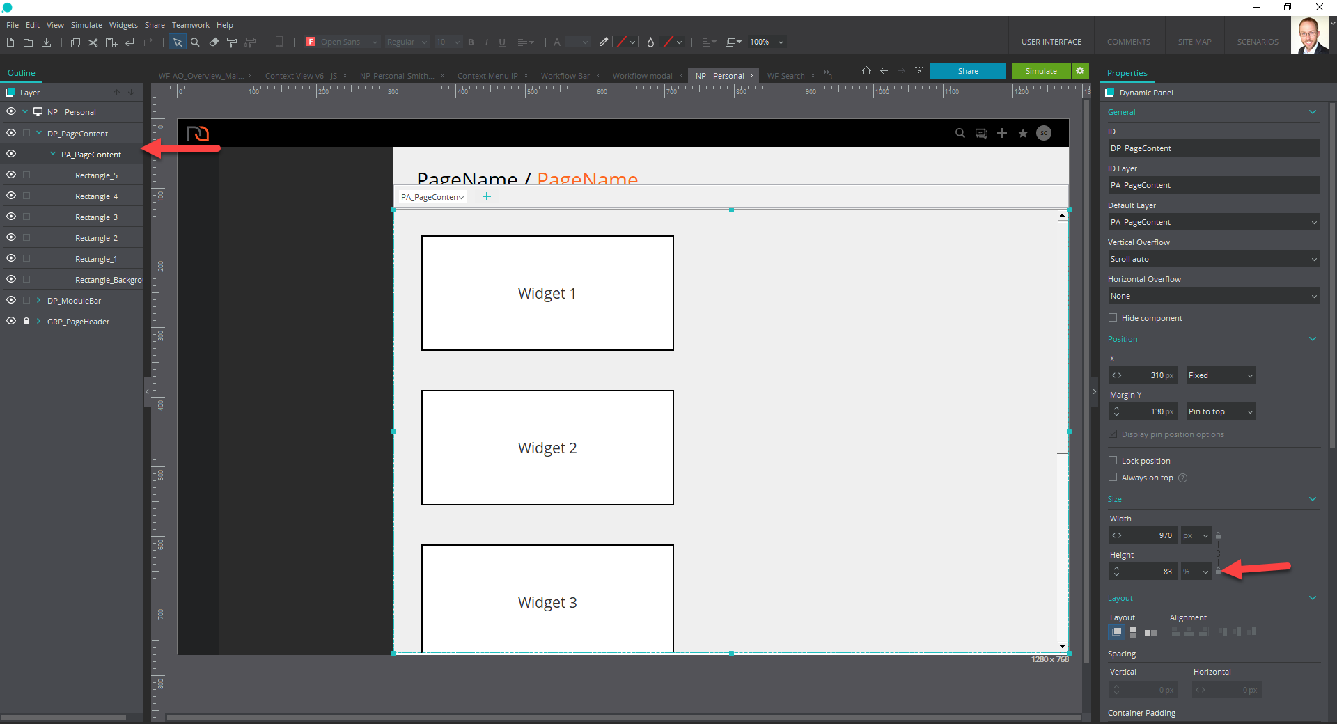

- I created a dynamic panel for the "page content area". It is pinned to the top with a Y margin of 130px so that it starts after page header section. (see screenshot 0).

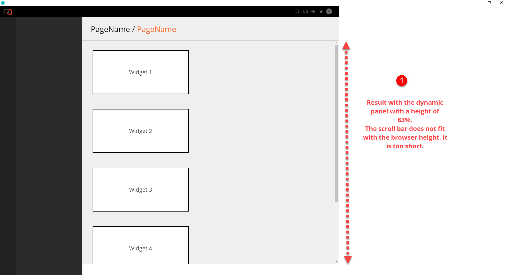

- If I give to this dynamic panel a height of 83%, so that it fits (approximatively) with the screen's height, then, during the simulation, the page content area is too short and does not take the full browser's height. (see screenshot 1)

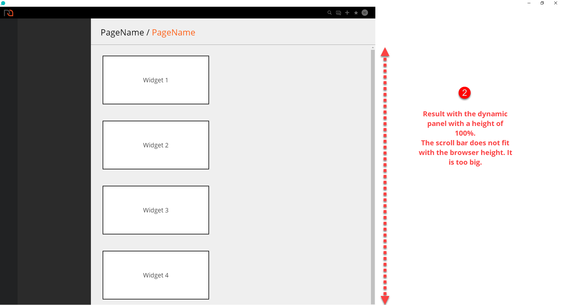

- If I give to this dynamic panel a height of 100%, then, during the simulation, the page content area is too big, and the bottom of the scroll bar is not even visible. (see screenshot 2)
- The screenshot 3 shows the result I am looking for. To make it work in the simulation, I had to set a fix height to the dynamical panel, corresponding exactly to the height available in the browser when displayed in full screen. Of course this is not what I want either, because as soon as I resize the browser's height, the page content area, and its scroll bar, do not adapt to the new height.
