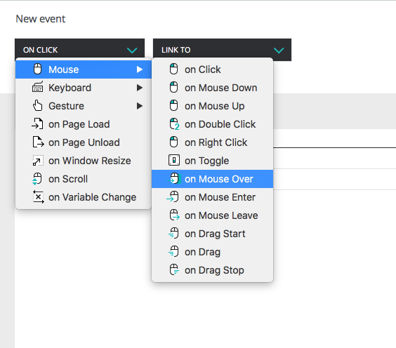

Where is mouse enter event in latest version of justinmind?
When creating an event, go to Mouse, and scroll down the drop down until you see "On Mouse Enter".

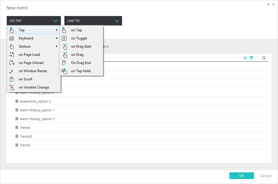

I couldn't see mouse event in list of event. I am working in 8.5 version of justinmind. Is there an another name for this event? Can you send me a screenshot of the screen you are trying to convey?
Sure - see the screenshot.
In 8.5 version there is no such event.You can see in screenshot attached.
I see the issue - the on mouse over is only available for non-touch screen devices, like Web. You can't create an 'on mouse over' event for devices like the iPhone, Android phone, or iPad.
Okay. got it. Thank you for your help.
