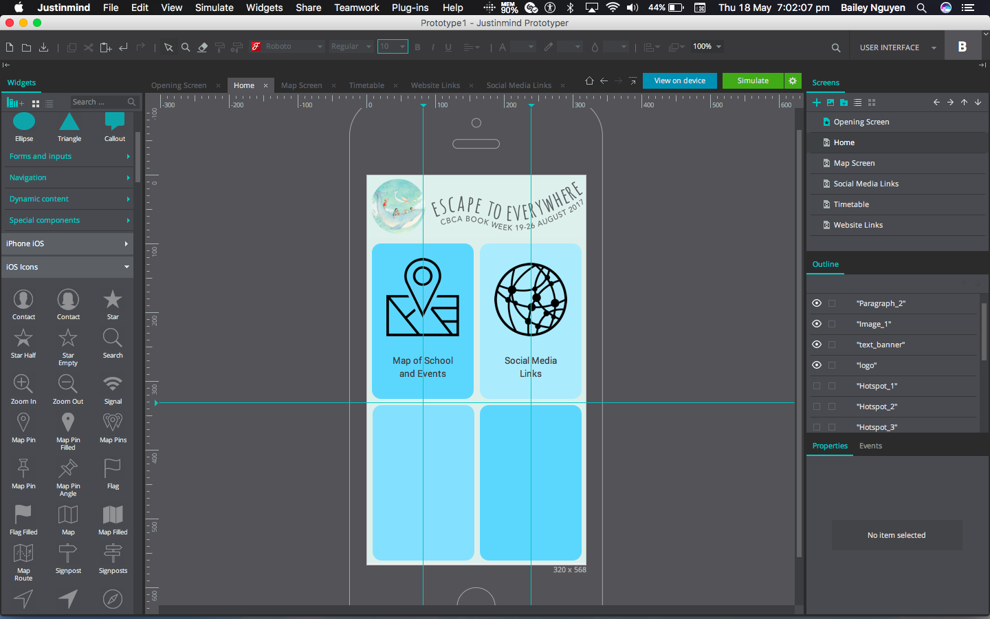

How you can create a social media share button like you see on other applications for an application prototype in Justinmind?

Attached is screen shot of a menu I have made for an app. This app is for a school project where I have to create a digital solution for the advertisement and promotion of an event. The top right button links to a screen where I'd like to have some more buttons. These buttons when pressed would come up with a window to 'share' something, for example a selfie taken during the event, to the Facebook or Twitter pages of the host of the event (using the user's accounts already on the device). You can see examples of this pop up window on websites such as http://9gag.com

You will need to design your own share button, however you won't be able to integrate that button with real social media networks. The following tutorial shows how to create a pop up, you should get some ideas with it.
https://www.justinmind.com/support/how-to-create-a-confirmation-pop-up-in-your-interactive-mobile-app-prototypes/
