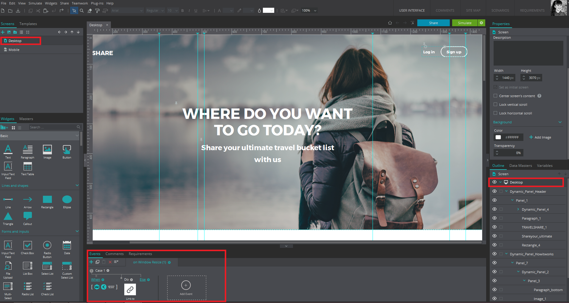

I have downloaded the simple responsive example prototype and working with it, I noticed that when I simulate it in the browser I can see the title and body text reflow as I change the browser screen from desktop to mobile size. I can't duplicate this auto text flow on mine.
So what is the property or behaviour that I have to do to have the same effect? Is it in the paragraph property? Must the text be within a Dynamic panel? Pin? I simple can't figure how to do it.

Sorry for our late response. The attached screenshot shows the main event that you will need to add in your prototype. Hope this helps.
