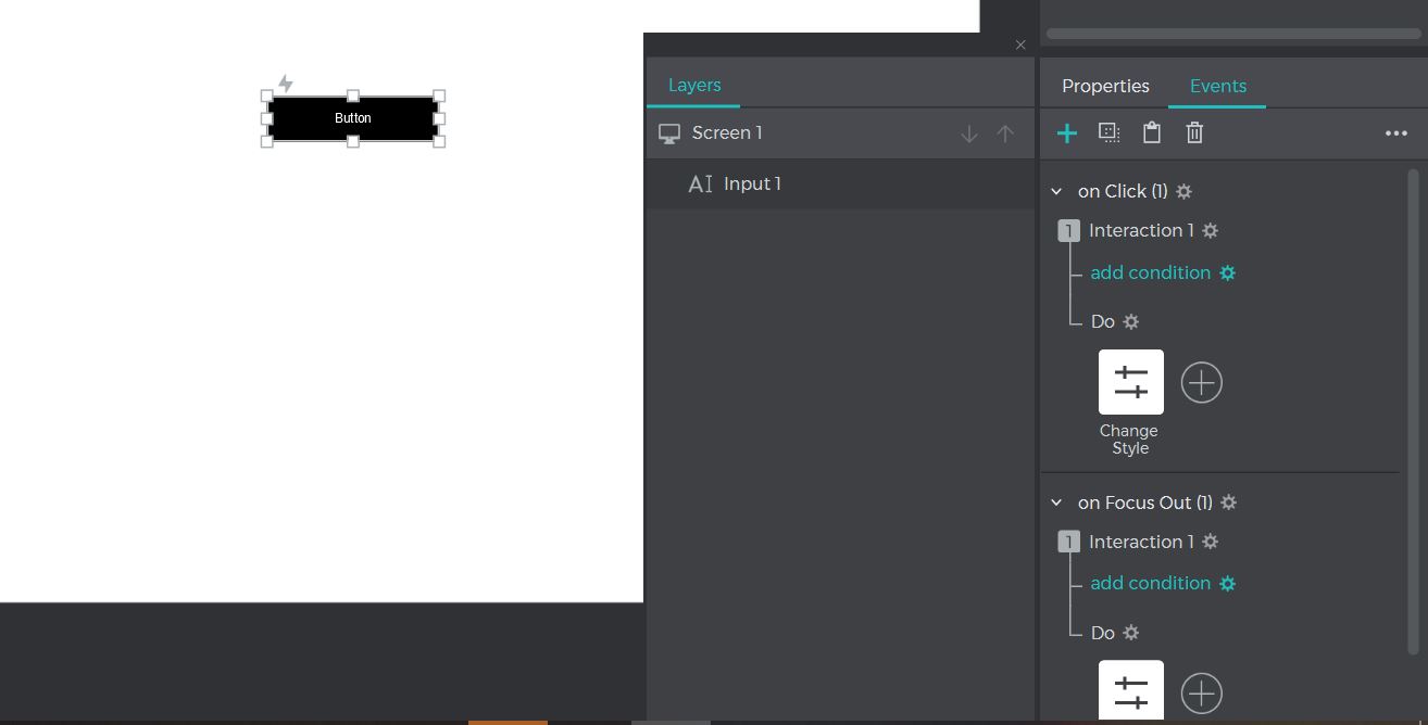

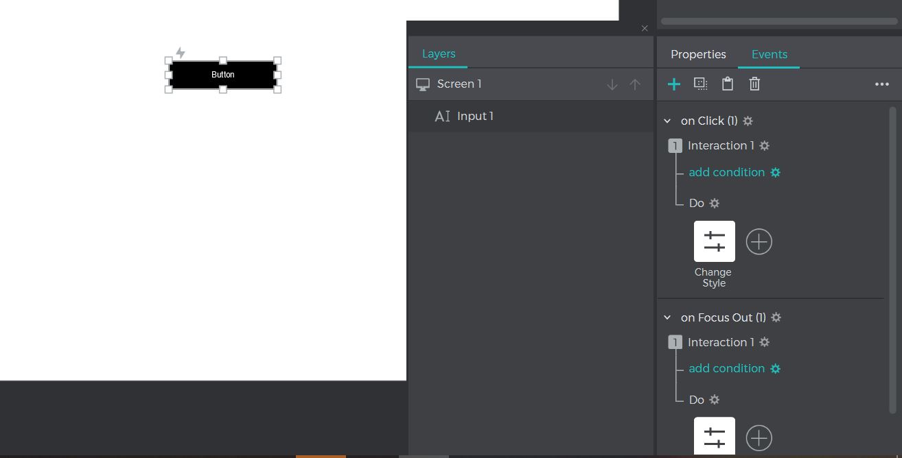

Hello, the focus out is in the text boxes, so we could use one to recreate this effect, I attached an example, let me know if it was useful.
Greetings.
Thanks Ria how do you get the on focus out (1) interaction? I don't see how to add it in JIM?
Hi Steve, the "on Focus out" interaction is enabled when the event is done on an input.

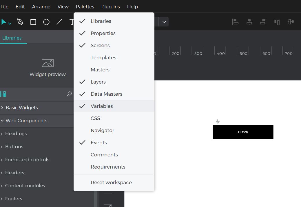

I don't see where I can choose on focus out?e9d154046a6b46660d2f1b0307fe2e22
Hello, the events palette is made visible from the palettes option in the menu.
Let me know if this information helped.
Please see screen shot above.

HI Ria, I am trying to add it to a button I created, which isn't an input.
So I took your button and style it to look like mine so I can take advantage of the input properties. This wasn't clear to me before.
