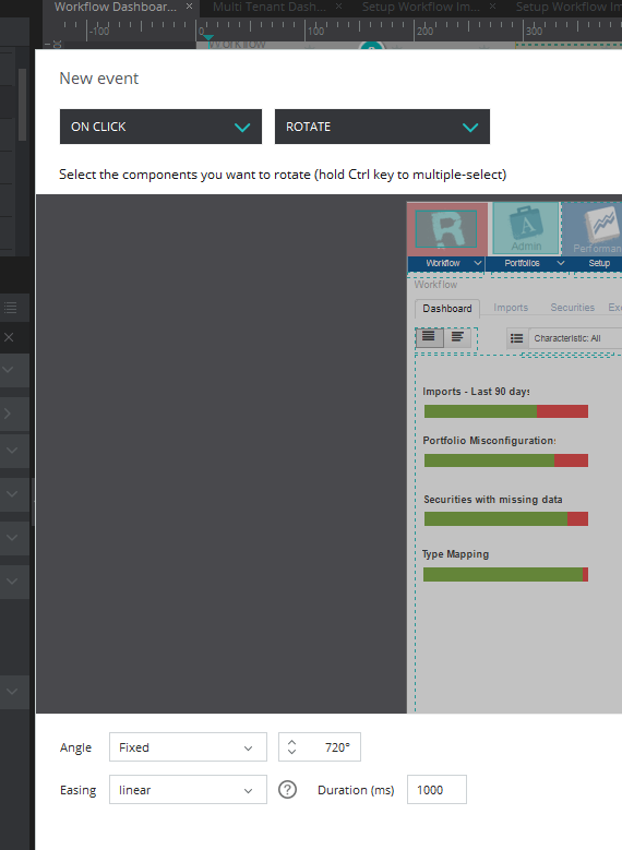

I have a star icon which indicating 'Saving' and need to make the star spin at the spot where it is for a short time to catch some intention once the screen loaded.
You can use the Rotate event and set a rotation greater than 360 degrees, a linear easing, and in a time that is reasonable for your spinner.
