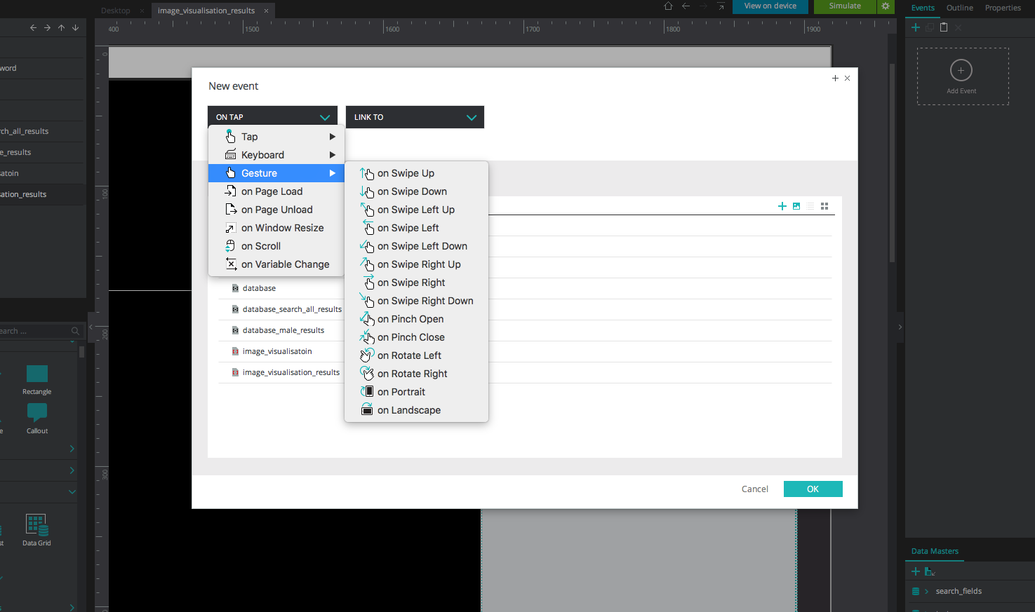

if you could point me to where the 'mouse over is', that will be great. I do not see it at all. here is my screenshot.

Hi Eugene,
It depends on you documenttype. Try setting up a webpage document and see if it appears.
Sil
Hi Sil,
May I know how do i set the document type? the size of my canvas is custom as i am prototyping for a desktop application.
Regards,
Eugene
I don't think you can adjust the document type once it's set.
The custom device is set as a tablet/phone. You can see the type in the outline panel. The icon shows a phone.
You can start a custom screen size for desktop when you select web in the new file menu. Now the icon in the outline panel shows a desktop screen.
