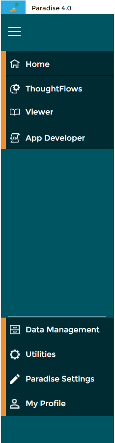

I've got layers hidden in my template I'm working in, but then when I go to simulate, those hidden layers appear. Any insight into what I'm doing wrong?

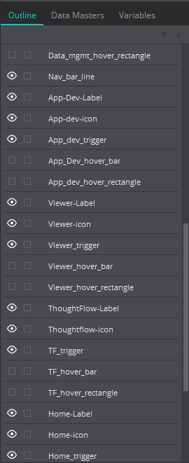

The black and orange is only suppose to show on hover. I created a transparent rectangle and am using it for the trigger, but those layers should start off hidden, and then show when you run over the trigger. If I mouse-over and then mouse-off, it behaves like it should, but it starts off showing when it should start hidden.
Hi Laura,
The components in your prototype shown in the hiddenlayers.png aren't actually hidden during simulation, just while editing. To hide a component during simulation, select it and look to the properties palette. There, tick the 'hide component' box.
