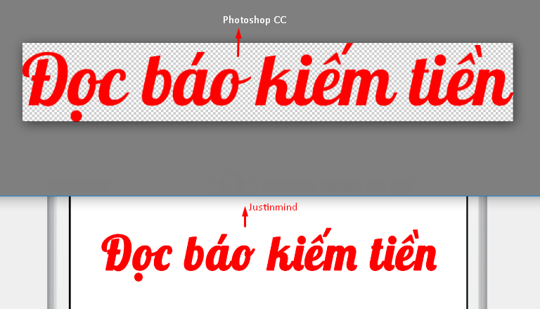

I'm using Justinmind v8.3.1, my customer complain the font is thin more than normal. After that i compare 2 image with the same font style, the same size of text but it is very different (attach file).
I believe the font when written on phototshop will be more accurate. So i hope you review it and soon to resolve.

The image sent you using Lobster Regular.ttf

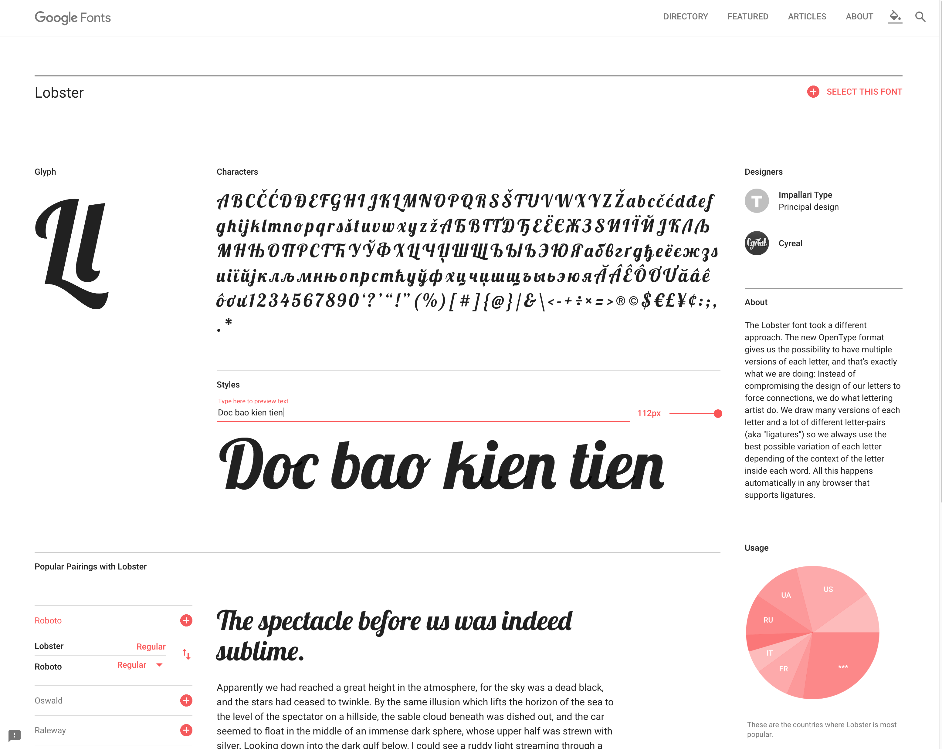

It seems that the font you are using in Photoshop is not the same version of Lobster that is being used in Justinmind. You can compare the font used in Photoshop and "Lobster" here: https://fonts.google.com/specimen/Lobster

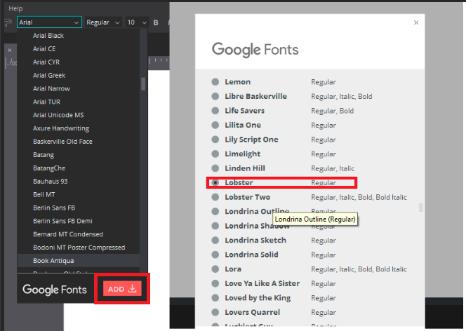

Justinmind (version 8.3.1) includes the most updated version of "Lobster" from Google Fonts. See the screenshot attached.
Please check out that your font is official and/or the most updated version of the font.

You should follow these instructions:
1. Uninstall the Lobster font that you are currently using on your computer.
2. Download "Lobster" from Google Fonts https://fonts.google.com/specimen/Lobster (this is the official Lobster font)
3. Install the same font (Lobster) directly in Justinmind. (See the screenshots attached)
4. Restart your computer.
