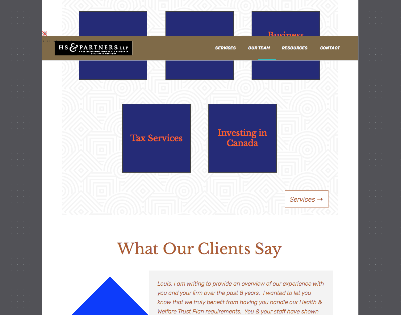

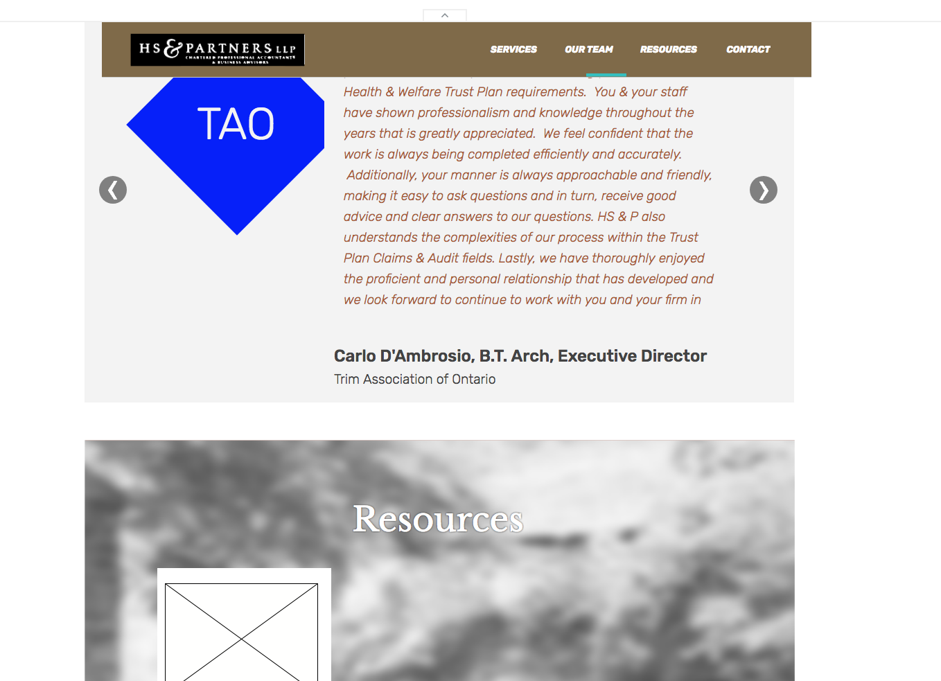

The floating menu seems to always and consistently misaligns around 20 pixels left going off the canvas even when I create a new file and place the default floating menu. Is this a bug or am I doing this wrong?

Thank you for the quick response. The issue is easy to reproduce:
Mac OS X
Screen : Web (1024 x 768)
Simulated in: Chromium, Safari
I just drag/drop the floating menu below the height of the initial screen on the canvas, making sure 'Left' is 0px. Even when you move the menu in JustInMind horizontally, the menu in Simulation always seems to be placed around 20px from the left.

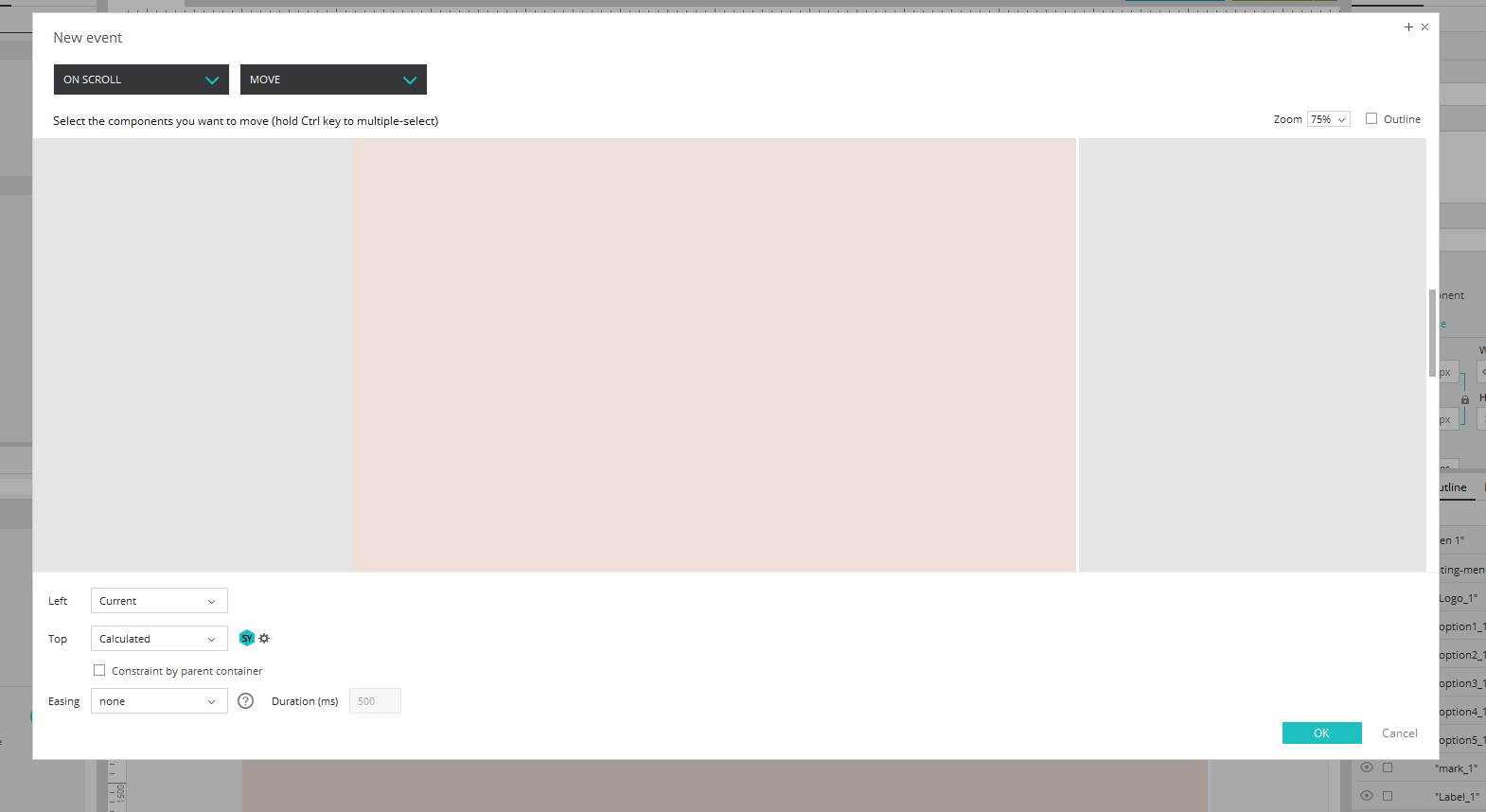

Dear Ocelot,
I've been reviewing your example and what happens is that the "on scroll" event has an action to move the menu 25 pixels left. You should replace this option as "current". See the screenshot attached.
