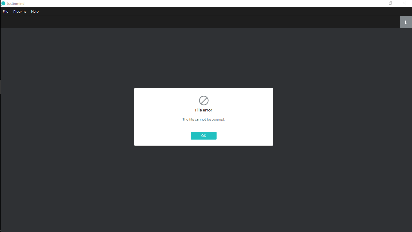

My JustinMind wasn't opening so in another one of the community forums i told me to reinstall it which i did. But now when i try and open the file i show that error. Please helpb8816293a660a37f5b92150d8e440e48
My JustinMind wasn't opening so in another one of the community forums it told me to reinstall it which i did. And the program would finally start. But now when i try and open the file/prototype i was working on i show that error. I made sure to save my file to another folder and i even saved it on a flash drive, Please help (that's the more specific version of what i'm trying to say, for some reason it wouldn't let me edit my comment.)
Which version of Justinmind did you make your prototype with? Are you trying to open it with a previous version of Justinmind?
