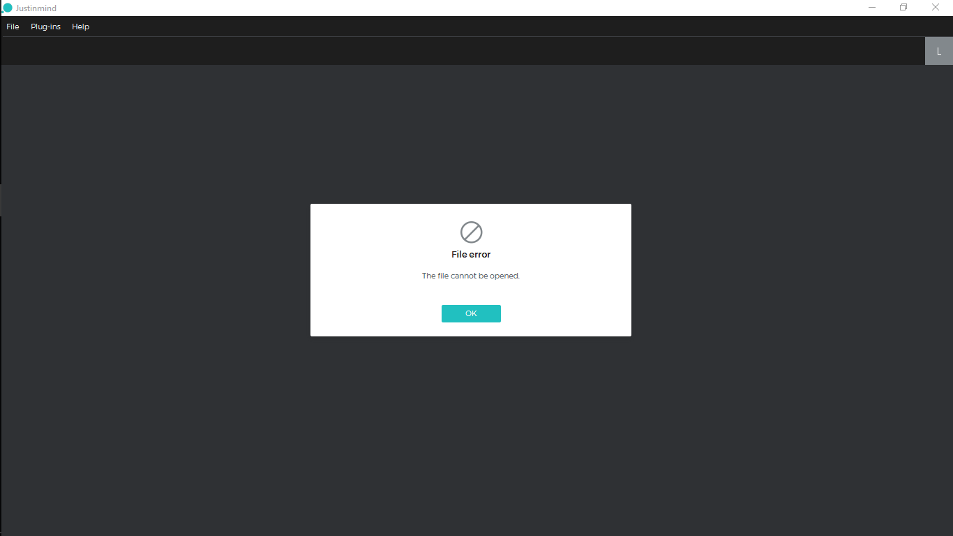

File unable to open file after reinstalling JustinMind
Solved Larox ● 6 years ago
My JustinMind wasn't opening so in another one of the community forums it told me to reinstall it which i did. And the program would finally start. But now when i try and open the file/prototype i was working on i show that error. I made sure to save my file to another folder and i even saved it on a flash drive, Please help

Yes i did that and it still wouldn't open. I still keep getting the same error saying that i can't open the file.

The file you have attached is corrupt and can't be recovered. Do you have any backup copies of this file and any that show up when you go to File - Open Backup copy?
Also, if you could attach your log files that would be helpful to us.
If that doesn't work, you can also go to your online account and get any Published or View on Device copy from there.
