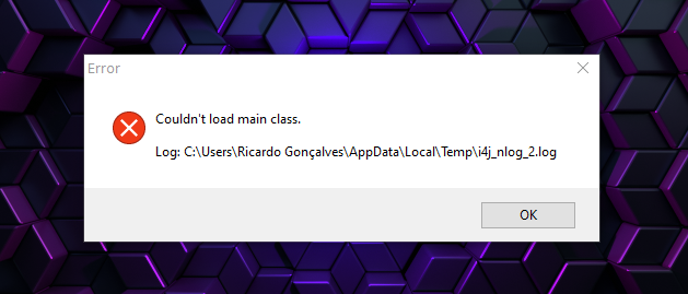

I'm trying to install Justinmind but I got an error "Couldn't load main class"
Logs:
[16:798] used stack size 0
[16:798] Creating JVM
[16:945] JVM created
[17:46] ERROR: did not find NativeLogger class
[17:46] load helper dll
[17:46] helper dll (in-module) 00007FF771280000
[17:61] ERROR: did not find com/install4j/runtime/installer/platform/win32/Common
[17:68] ERROR: did not find WinDel class
[17:68] setting exe4j.moduleName to C:\Users\Kinga Osińska\Downloads\Justinmind_Prototyper_Windows.exe
[17:68] main class: com/install4j/runtime/launcher/WinLauncher
[17:83] ERROR: could not find main class

The 9.3 update did not solve the "load main class" issue for me.
However, i was able to install the software by creating a new Windows user without special characters.
Hope this helps.

Would you mind helping us one last time? Could you please look for this information in the user with the special characters? You will need to activate the 'see hidden files' option in your file browser:
1. Open this folder C:\Users\Manuel Perdigão\AppData\Local\Temp (AppData is a hidden folder. And we're assuming Manuel Perdigão is that user with the special characters you were mentionig)
2. Send us any file in that folder that looks like this "i4j_nlog_1","i4j_nlog_2"
Thank you!!
Hi Victor,
Sorry, i already deleted the old user account. But i do remember those "nlog" files were created in the temporary files folder each time i tried to lauch the installer.
