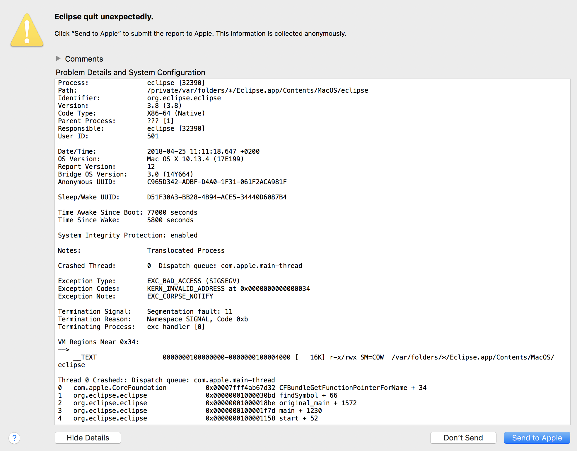

Hi - running the Eclipse SDK on the latest MacOSX High Sierra I get a 'segmentation fault' on startup which is perfectly repeatable, see screenshot. How can I run the SDK on my Mac?

Yes, that fails with the same message.

Yeah this was very odd - if I use Finder to simply explode the .dmg then it fails to load with the access violation, but if I use Path Finder file manager then it runs as expected. So I've got a fix - thanks for the help and the excellent debugging !

It seems that the bug/fault is back in 10.13.6.
I tried the zip fix, using my terminal rather than going through the finder. But that didnt do much for the problem.
I get the same segmentation fault as Colin
