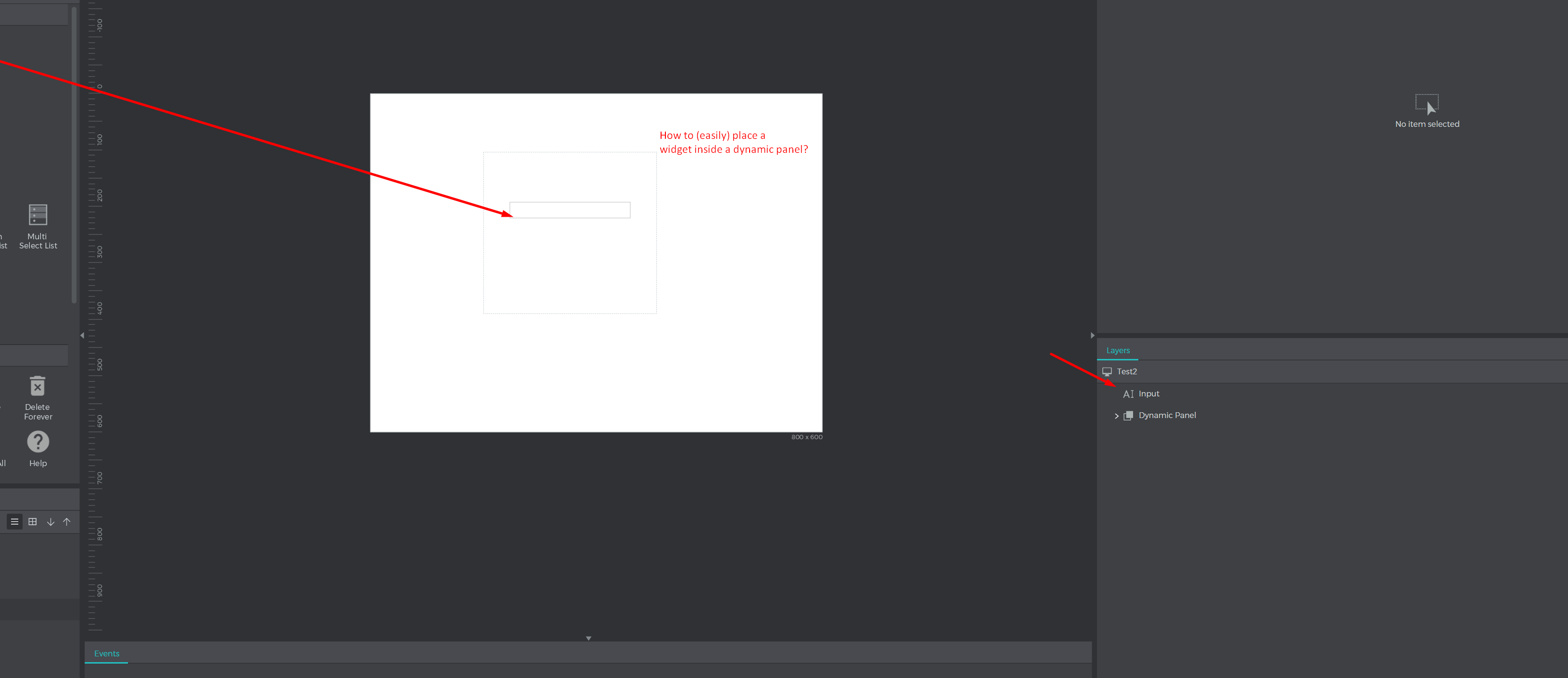

Is there a way to drag an new object from the libraries panel into a dynamic panel in v9? Whenever I try to drag an object onto a dynamic panel it places it on top of the panel, but outside of the panel. The only way I can figure out to get an object from the library panel into a dynamic panel is to copy/paste it.
Hello,
Thank you for reaching out. If you click and drag a new element from the libraries panel into a Dynamic Panel you can hold Ctrl when you hover over the Dynamic Panel, it should highlight the panel and then when you drop it in it will place it inside of the Dynamic Panel. Let me know if this works!
