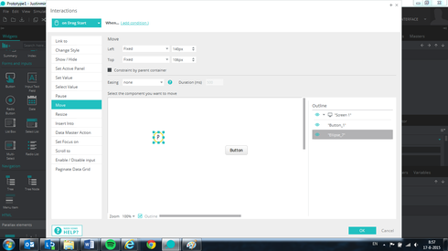

I am trying to drag an elipse in an IPad setting to a position it will be dragged to and keep in there.
I have read the following link repitidly:http://www.justinmind.com/help/html/d...
However, I do not even get the option "select the option 'With cursor' " when i look under "move". It does not appear in my screen. I thought that maybe it does not work on an app for IPad and tried seeing if the options became vbisible in a web setting. this does not happen either. Am I forgetting to select something stupid and small for this to happen? This is very frustrating. 869f3683bea252db9c08f3b7499ce1d3
Hi Sophie,
You should use the 'on Drag' action instead of 'on Drag start' to have the option 'with cursor' available.
Lidia
Dear Lidia, for some reason I only had that as an option under "on drag" after restarting my computer. Weard, but thanks! :)
