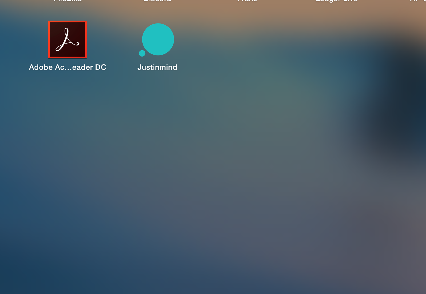

Hi Chloe
Yes after installing from the DMG, I dragged it into the pplications. Its on my applications now and it still cant be opened.
Its on the applications page

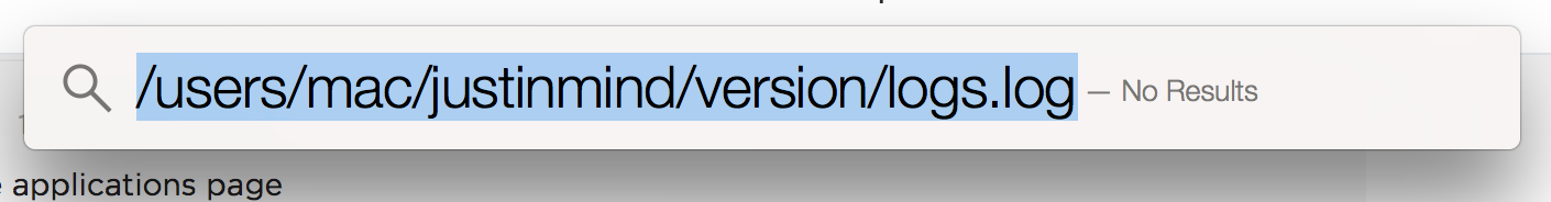

- After it tries to launch, then send us these log files:
/users/youruser/justinmind/version/logs.log

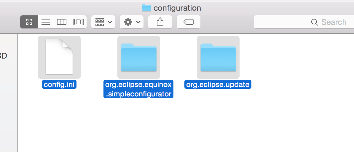

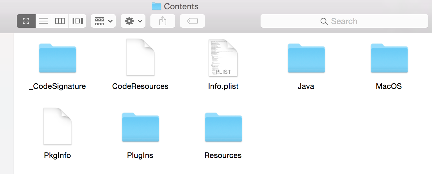

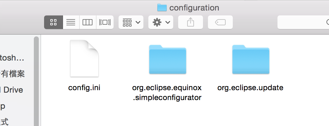

Open Finder, go to Applications, Right click on the Justinmind app and select 'Show package contents'. Then send any .log file in this folder /Contents/Java/configuration
I tried to find my log files. But there's no results i could find. Am i doing the right thing?
I dont see any log files in my /Contents/Java/configuration as well
Is this the log file?

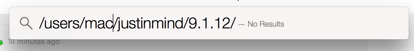

Can you send a screenshot of this folder?:
/users/youruser/justinmind/9.1.12/
there's nothing as well.
Here's my package contents.
What about here?

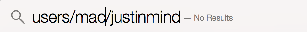

Thanks for all your help, by the way
theres nothing too.

Sorry to hear that. Can you check if there are any log files in this folder and send them out to us?
[Path where Justinmind was installed]/configuration
this is all i see.
Hi Hubert,
We're sorry it took us so long to realize the source of the issue. We were focused in looking for potential bugs in the code and we forgot to ask the most basic questions. The thing is that Justinmind is only compatible with macOS 10.11 and newer versions. I think you have 10.10. That's why is not launching. If you ever update your OS, you will be able to launch the product.
