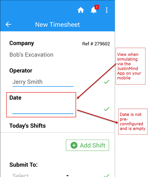

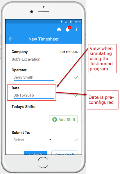

When designing for mobile view the date widget is not pre-configured when you simulate. Please see below steps to replicate:
1. Design a prototype for mobile
2. Drag the date widget into the canvas
3. Pre-configure a date so the date is displayed in the prototype
4. Click simulate
Issue:
The date is not being pre-configured and the box is blank.
Is this a bug in the application?

Hi Sonia,
Thank you for getting back to me. Please see attachments.
Let me know if you need any further information.
Hi Rikki,
Sorry for my late response, i've been out of the office a couple of weeks. You are right it's not possible and it's already on our backlog. Meanwhile, as a workaround, you can create an "On page load" - "Set value" event to simulate the widget.
