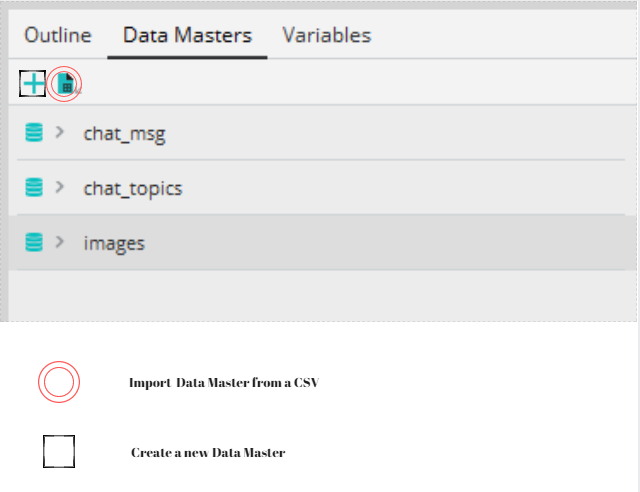

Unfortunately, only the text attributes can be imported from a DM through CSV. As a workaround, you could create a DM with all the attributes you need (text, category, ...) and then import all the other instances from the CSV. Hope this helps.

As a clarification, you won't be able to use the option "Import Data Master from CSV" directly as Justinmind can only import text attributes (Not categories) however if you create first the Data Master (New Data Master) you should be able to "import data from a CSV file" without any issues.
