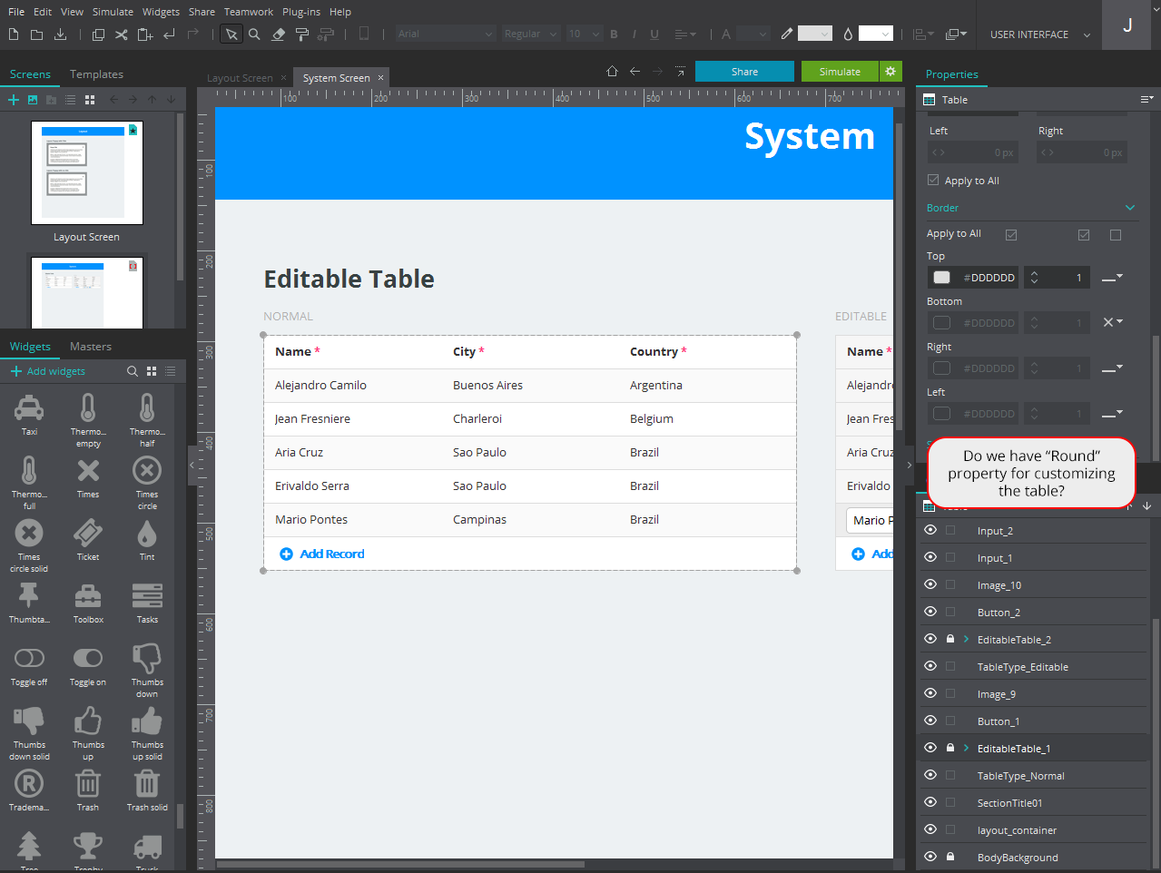

My next question is about customizing the corners of the table and make it round, is it also possible? Because "Round" is missing in its properties.
Unfortunately it's not possible to round the corners of a table right now, but I'll let our team know that this would be helpful.
A workaround could be to remove all borders in the table and make the background transparent. Then, place a rectangle with the desired roundness behind the table. It would then look like the table is rounded.
