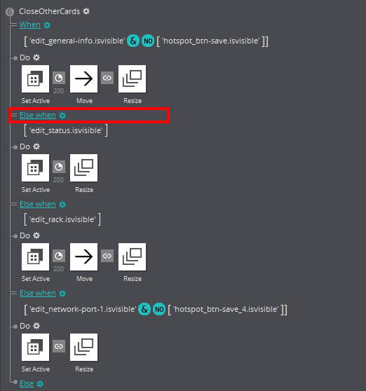

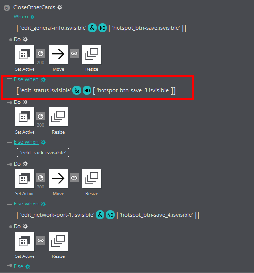

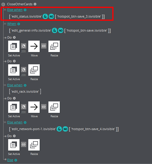

I found the same problem. When you copy/paste a condition into an existing event (see pasting-into-existing-event.png), that is part of a list of conditions, the visuals in the 'Events' tab become corrupted (see visual-bug-after-pasting.png) by showing the conditions out of order. You need to click on some other layer in the outline and click back on the object that had the event pasted into it for it to show up properly again (see visual-bug-reset.png). At first I thought, like the original poster, that something went wrong and that I had to reload the whole file from the last save.
You are right. It's a bug that our development team will need to solve on future updates.
Thank you for taking the time to report this and sorry for any inconvenience.
