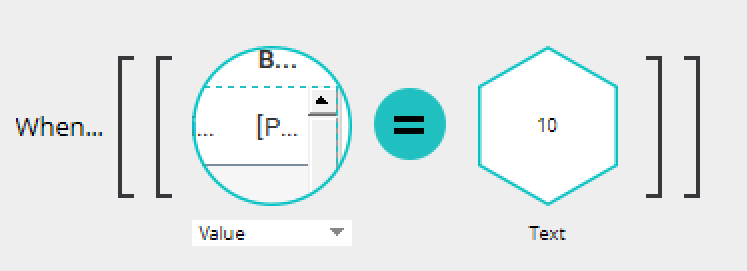

Hi Michael,
You can do this by creating an On Page Load -> Change Style event. Then, create a condition that will be When.... [input 1] = [value of one of the input fields]. I have attached a screenshot of how this will look in the expression builder.
Let me know if you have any questions.

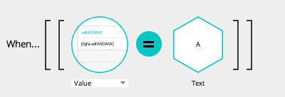

Danielle,
I expected it to work as you described and tried itseveral times before I submitted this issue. Today, I tried it again (several times), and cannot get it to work.
I have the event setup for format change to execute upontap of an OK button from a message dialog, with the desired field to be changedselected in the data. My testing resultsare as follows:
· With no Condition in front of the event, the textcolor of the field is changed for all records (test as expected, and confirmsthat my event is setup correctly)
· With a Condition as you described in front of theevent, and the Condition equal to the value of any record other than the first,no format changes occur (test failed)
· With a Condition as you described in front of theevent, and the Condition equal to the value of the first record, the field ischanged for all records (test failed – interestingly, this appears to suggestthat the Condition is only validated when it is the first record of the list(incorrectly – as it should work for any record), and it also incorrectlyupdates all records to the format change (not just the first record)).
I have tested this many times (including different fieldsin the data list), and can replicate the results each time. The positive result (first bullet) confirms that my Event is setup correct, and both of the failures confirm that there iseither an issue with my Condition statement, or there is a defect in the logicof the application. I have attached a picture of my Condition statement. Please advise.
