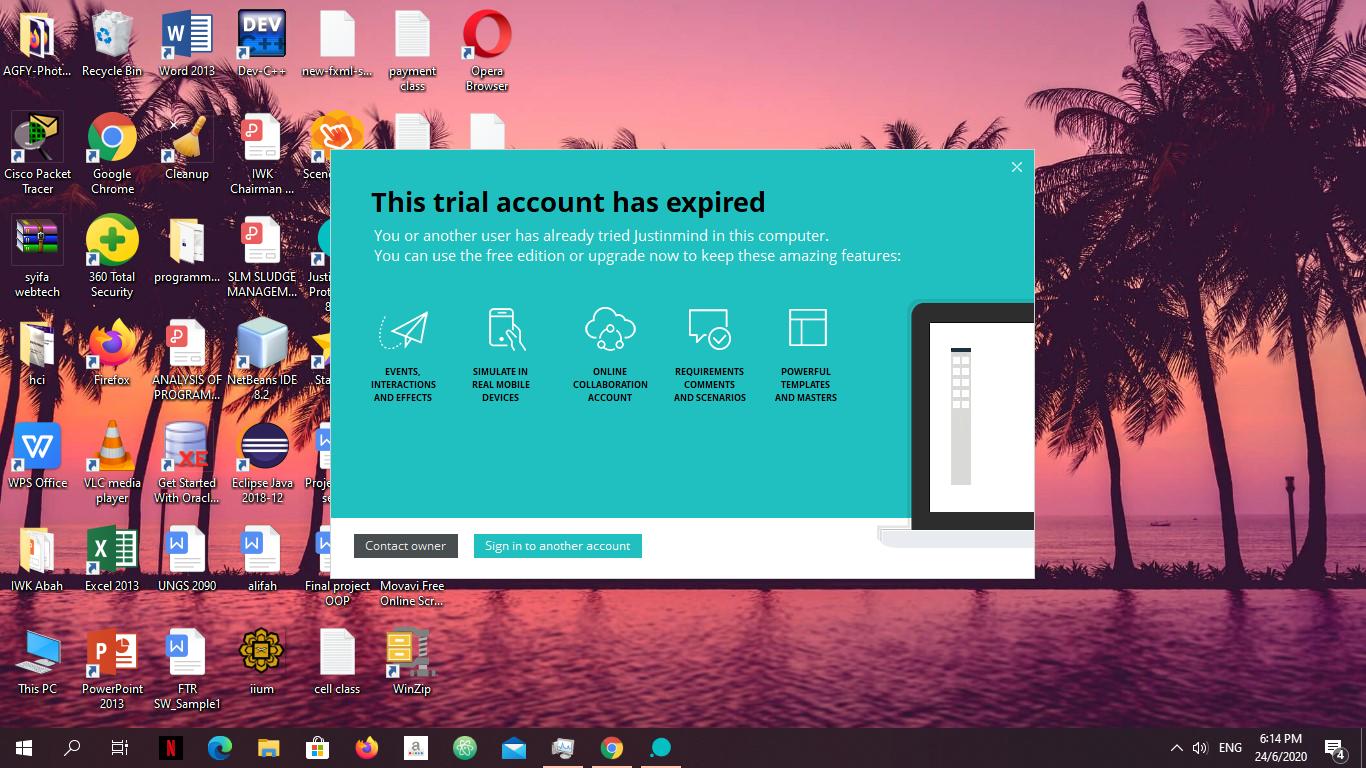

I want open shared prototype from my account. When I login into my account and choose my friend's account to view the prototype, the shared prototype won't open. What should I do? The picture I attach is the one that come out when i want to view the shared prototype. Can't I view the shared prototype using free account?
No, you will not be able to open a shared prototype with a free account after your trial expires. You could try having your friend open the Shared prototype on their computer and then going to File > Save a copy. They can then send you that .vp file, which you will be able to open with a free account.
