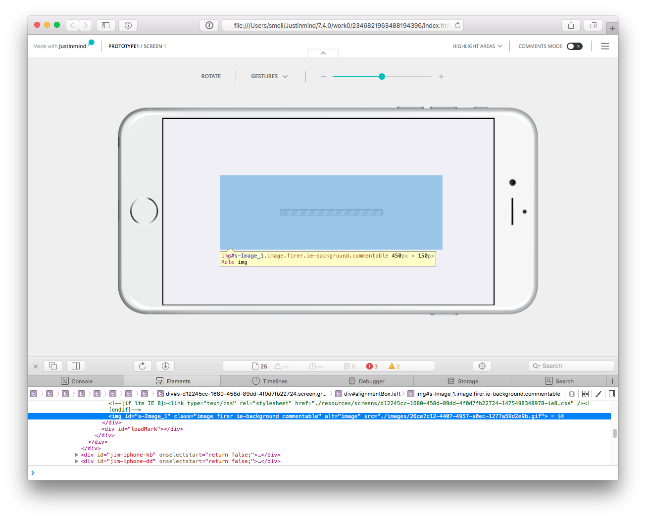

I've got the latest version of the Pro app and I'm not able to put this animated GIF into my prototype:
https://www.siriusxm.com/sxm/img/global/loading-bar.gif
How did you get yours to work?
All I'm doing is saving the file locally, dragging it from my local computer to the Prototyper app and dropping it on the screen where I'd like to see it.
I've attached a screenshot showing the preview and source code so you can see it's still a GIF file. Here's a public URL where you can see it in action as well as view the source to see it's still a GIF file and I've attached the prototype file for you to look into.
https://dl.dropboxusercontent.com/u/628429/justinmind/loadingbargif/index.html#/screens/d12245cc-1680-458d-89dd-4f0d7fb22724
HTH.
Thanks @stpnh - So, looks like I may have found a bug (and why it wasn't working for me). Try cropping that gif, and running the proto. The animation stops. Evening undoing the crop doesn't fix it, you have to re-import the gif. Can you replicate?
Hi @SKZDEMOUSER, yes, I was able to replicate breaking the images animation by using the crop functionality as well as the flip functionality. I also tried to resize the image but that had no negative effect.
I've attempted to use several online image editing programs that allow you to alter your images and all of them also broke the animation except for services that explicitly stated they handled animated GIF files (e.g. http://ezgif.com/crop)
I'm not sure if Just in Mind would consider this a bug or a feature whose functionality is not apart of the tool. Seeing how they offer image altering functionality, I would expect that it didn't alter images in such a way that broke them.
