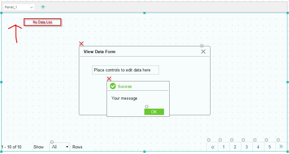

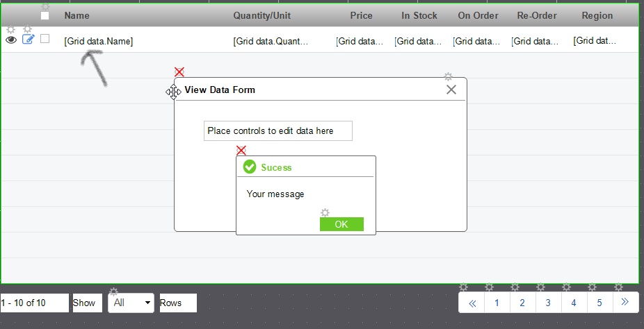

Hence I created this control in a dynamic panel using data list/data master. Please check attachment - "Grid control".
When I select the panel and create a widget, the data list disappears. Please check attachment - "Grid Control as widget"

Thank you for your reply. I tried the approach you suggested and it didn't work as not just data master, but even the data list disappears from the widget.
The reason I need data list available in the widget is because I have row level operations like edit and view defined in data list. I can work with data master getting disappeared as you suggested above, but unfortunately its not working that way.
