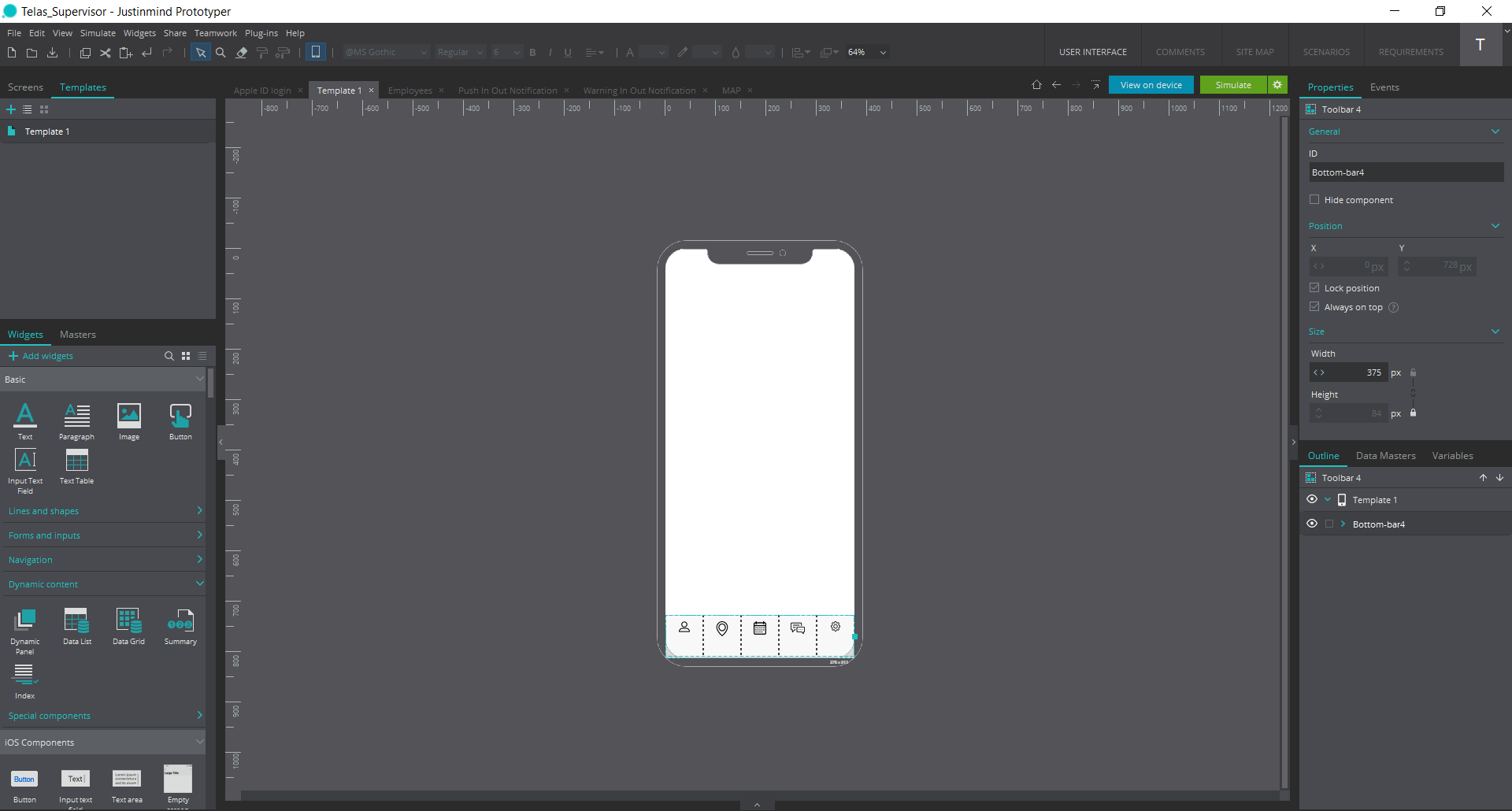

Hi. I did create a template1 and I did add a bottom-bar with the icons I need. When I try to simulate it, sometimes it disappear and sometime don't. I tried the lock position and always on top options with no success.

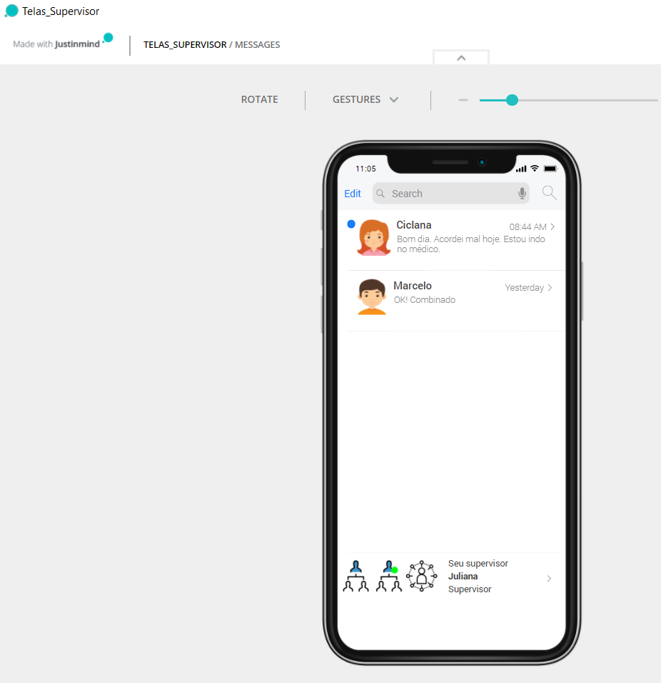

Generally it presents the buttons, but when I click in one of them to navigate between screens, it disappear.

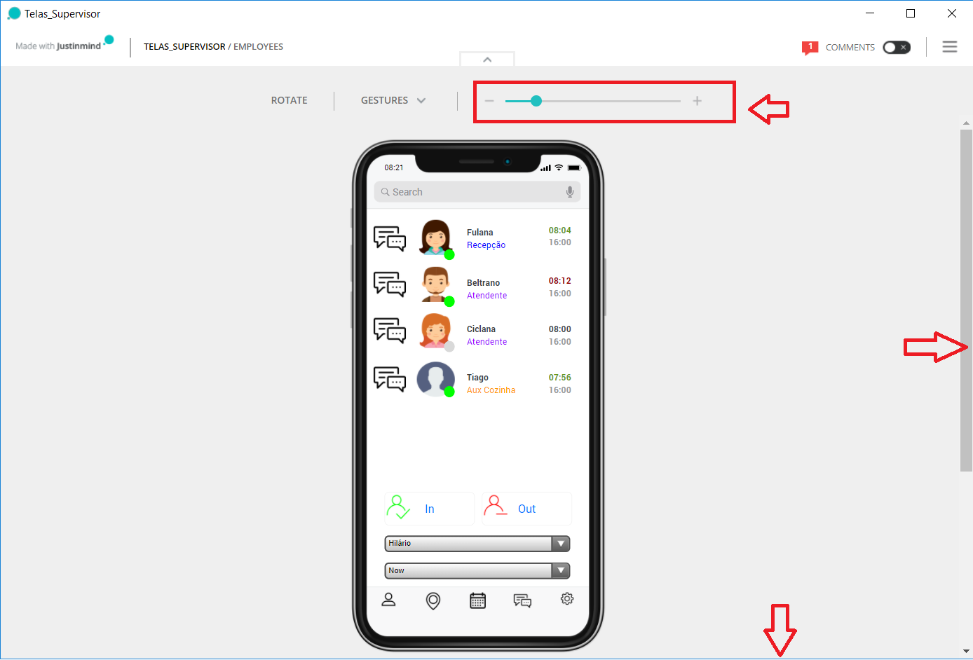

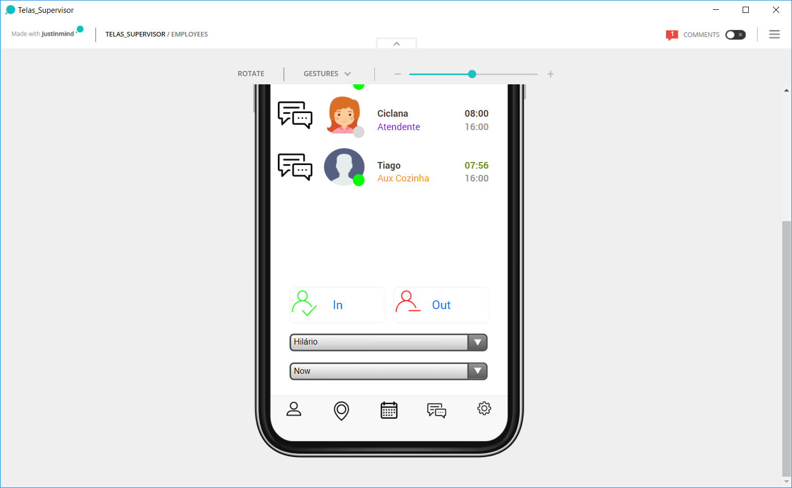

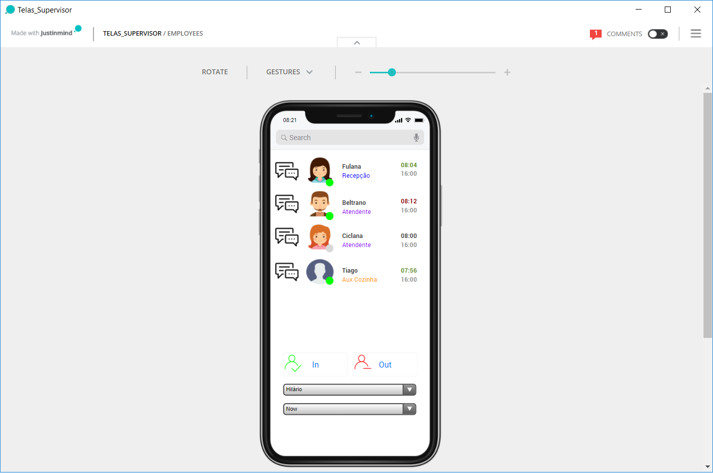

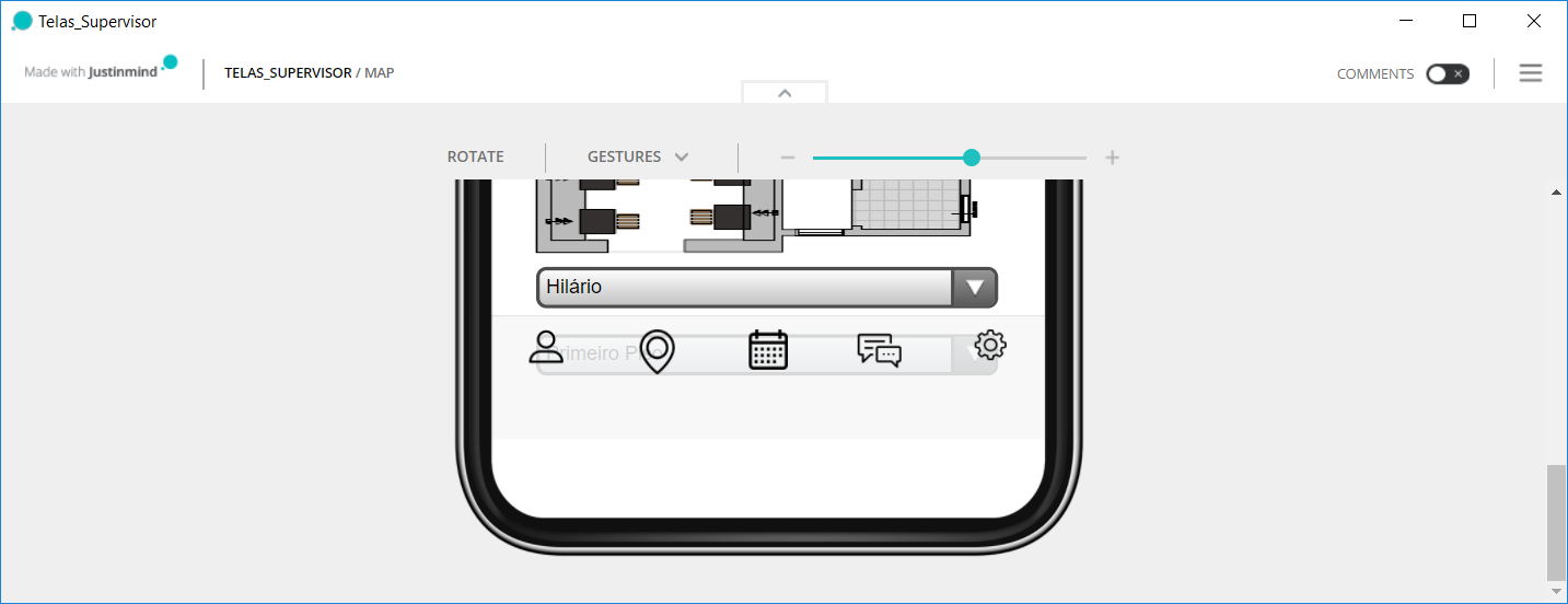

I did reproduce it in a different way today: when I simulate "Employee" screen, for example, I usually zoom out to fit the screen and then when I resize the screen it disappear. Attached some screenshots. Hope this help you to understand what I am doing, please let me know if I can do something else.

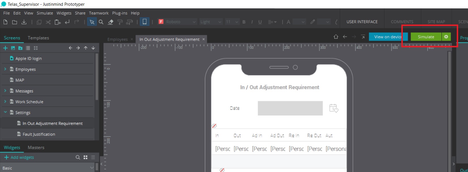

Hi, sorry, "new in town". I just press "Simulate" from the main screen, attached. Are there other ways for doing it?

We were able to identify the problem and are working on fixing it now. As a workaround for right now, you can unpin the bottom bars (template) for screens that don't have any scroll on them and it will work correctly.
