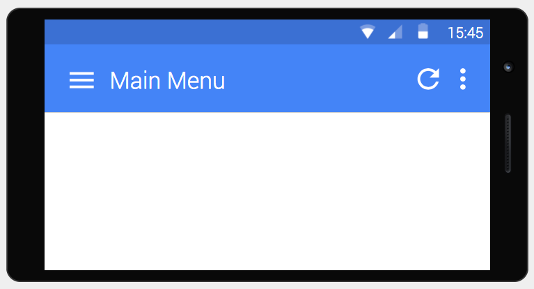

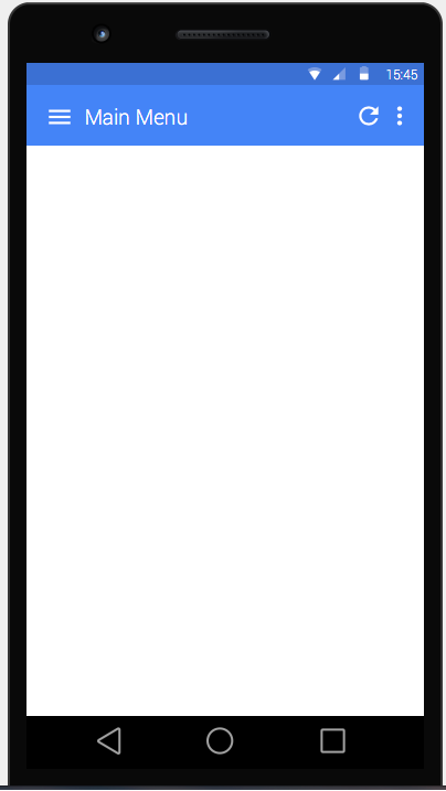

Sorry for our late response. An option is creating a screen adapted for both positions (landscape screen / portrait screen) and then link to the correct screen by creating an event (Gesture / On Landscape / Link to ).
