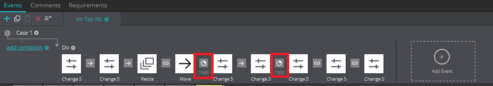

Hi Justin,
Your prototype contains lots of animations and many interactions associated, so this would be the main reason of your issue.
Another reason could be related with the fact that you have added some delays to the interactions with the " Time AFTER previous started" option with 1500/1000 seconds. Try to avoid this and use the option "AFTER previous" instead. That should improve the behavior a bit.

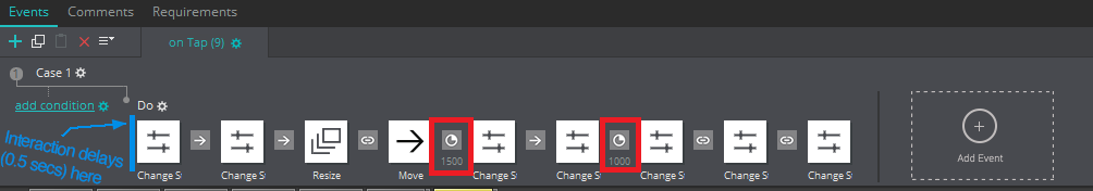

Hi Sonia, thanks for looking at my file and getting back to me. You're correct that I do have some built-in delays in my interactions, eg. the 1500 and 1000 millisecond ones you found. However, the delay problem I'm talking about is the delays at the beginning of the interaction chain, the first thing that is supposed to happen immediately after the tap. (the delays you've identified delay the 5th and 7th event in the chain, while the delay I'm talking about is the first) Please see the attached version of the screenshot you sent, to see what I mean.
Should a 0.5 second delay be occurring before the first reaction starts happening after a tap?

As mentioned the main reason is the big amount of animations and interactions. The more amount of interactions has the more the prototype will be delayed (between 0-0.5seconds) because Justinmind will need to process the information.
