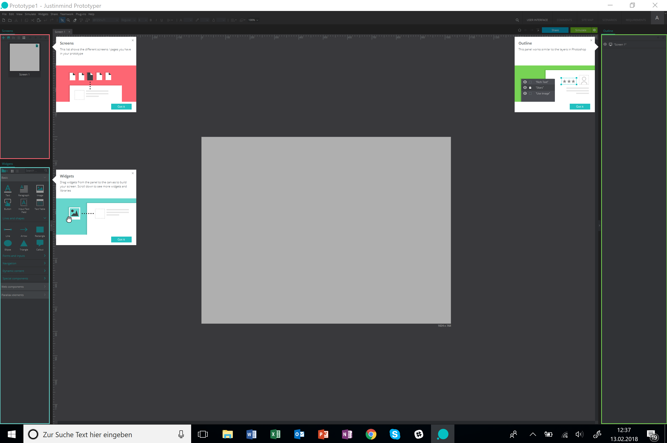

I have installed the application today in order to test it. However, I have trouble reading it at all since everything is displayed very small. I have a normal screen resolution. Problem exists both on Desktop/Surface as well as on tablet. All my other application are being displayed in a normal size.
Any idea what I can do? See attached a screenshot of how the application looks on my screen.
Dear Anne,
Look for and launch this file and it will fix the issue:
C:Program Files (x86)JustinmindJustinmind Prototyper 8.2.2 JustinmindPrototyperHiDPI.exe
