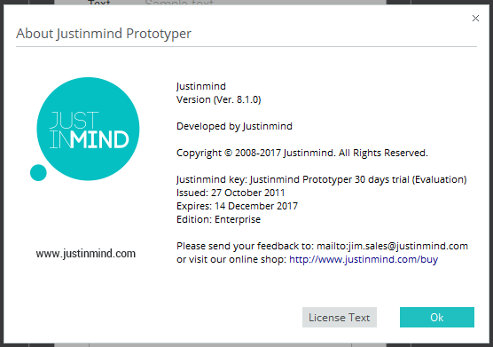

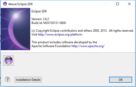

We are making justinmind plugin in Eclipse SDK as described earlier in this topic.
Version Information:
Eclipse SDK : screenshot "EclipseVersion" attached
JustInMind : screenshot "JIMVersion" attached
API Details:
JustInMind PlugIn project "JustInMindControlTypeDemo" attached
Prototype File "TestPrototype.vp" attached.
