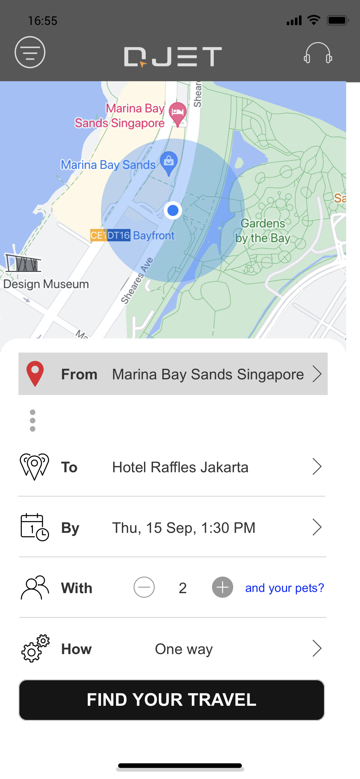

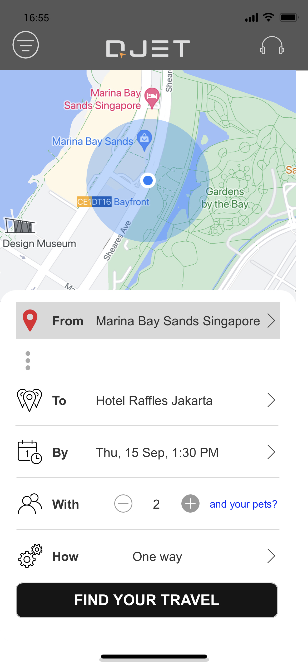

I have simple five pages prototype, which looks fine on desktop client as well as in images exported. However, when viewing on device from my iPhone 12 Pro, the alignments are all messed up and even some textboxes are disappeared.

Justinmind app - clicked "View on Device" from desktop client, and clicked "View on Device" on bottom of the Justinmind app. Attaching the screenshot from Justinmind app - you can see all content below the dark grey header is pushed to left and up. All other screens have the same issue.

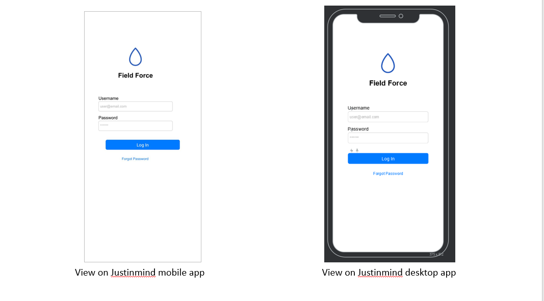

Sorry to hear that. Could you attach a screenshot of the simulation and of the prototype inside Justinmind to compare please?
I've attached it in here for your review.
I'm happy to say it's not an error. What is happening is the screen of your phone is bigger than the resolution defined in the prototype. The button shows up centered because, if you select it and check in the Properties palette, you'll see it's marked as 'pinned to center'. That means that no matter how big the screen, the button will be placed always in the center of that screen. The other elements don't have that option selected so they remain at the coordinates you place them. The quickest way to make it work with any screen size is to go to 'File - Simulate - Settings...' and set 'Fit to screen' as the Scale option.
